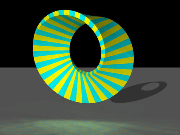

Mon, Aug 30, 2010 at 4:54:35 PM | How to build a mobius strip in revit?
NkatOmg2
NkatOmg2 Avatar
Joined: Fri, Jun 18, 2010
26 Posts
4 Stars: 1 Votes
Here is a picture.
 I use Autodesk Revit Structure 2011

this might get you started
http://bimtroublemaker.blogspot.com/2010/03/mobius-stripping-adventures-in-infinity.html
