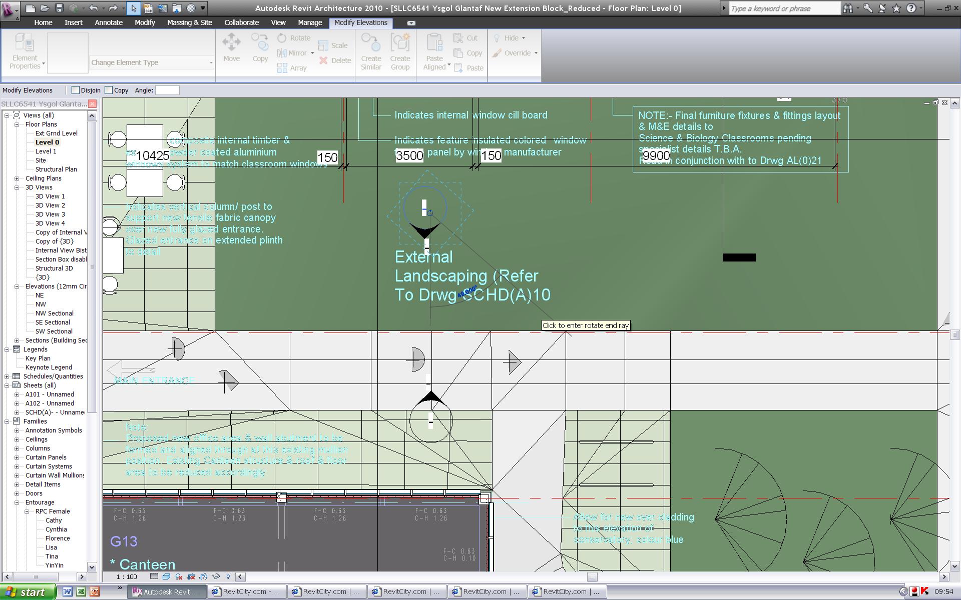

Hi I used the following method to create views that have the buildings square on their sheet  with the entry to the building at the bottom, but the elevation markers stay  squared to the actual layout of the project in mode space , not rotating with the view.
I have rotated them manually to be perpendicular  to the face I need the elevation of, but its not accurate and all of them are slightly off axis.
How can one rotate elevation view markers accurately..Im desperate!!!

Select the elevation and press rotate, you can then rotate it to any angle you wish, or if you make a new elevation and drag it close it'll align itself to your project then drop it and move it after when it's picked up the right angle
- Just trying to help out while I wait in the office for my renders to complete
www.danrossiter.co.uk
Wed, Mar 3, 2010 at 3:55:38 AM | Rotating Elevation markers accuratly
Kardiff
Joined: Fri, Nov 7, 2008
135 Posts
5 Stars: 3 Votes
here is an image

I have rotated them manualy but they are all ever so slightly off axis  and I cant get them exactly perpendicular to the face of the Elevation.....Will drawing the markers close on existing elevations make them allign them self too?

maybe too late, but I've just figured out the way haw to do it. I was desperate as well. The trouble is - to find the exact angle to rotate elevation. Here's what I've done: Open elevation view that is needed to be rotated, draw a reference plane perpendicular to the plan (perfectly vertical with other words), this refplane will appear in plan in exactly 90 degrees to your trobled elevation. Now it is possible to measure the angle between this refplane and wall or grid or whatever you need, will be something like 89,99989. Rotate elevation in a ususal way then. Worked for me, able to place dimension on objects that were 'not not exactly orthogonal' before.
