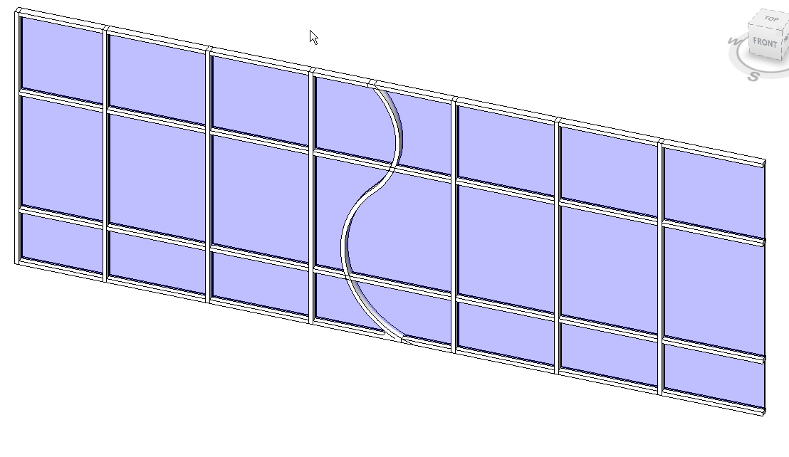

Here is what you can do....

How did you create that wall wwhub?
i have a wall thats mainly window except the lower half F.F to 3'
can you help?
Wed, Mar 3, 2010 at 11:04:34 AM | Trying to create Curved Mullions inside a curtain wall
That is two curtailwalls end to end.  Just modified the profile of each to be the curve and one has the curved mullions - the other has no mullion at the curve.

That's very nice WWHub!!! I also wish that they you can create a curve/arc grid lines so you can simply add mullions to it. The two curtain wall will work out well with just one curving mullion (like what you have in the picture). but what if you need to put like 10 mullions of the same? I'm guessing you need to create 10 curtain panel as well. wishlist?
 "If you tell the truth, you don't have to remember anything"
Wed, Mar 3, 2010 at 11:57:35 AM | Trying to create Curved Mullions inside a curtain wall
If I needed to do ten, I would only do one large panel with an in-place family that was all my curved mullions.
