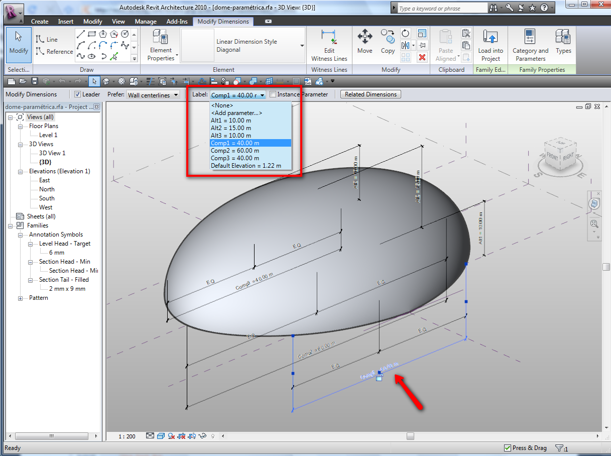

So, you must create that "Extruded Mass" parametric, create dimensions on it then turn the dimensions in Parameters (Labels), something like the image i just attached....

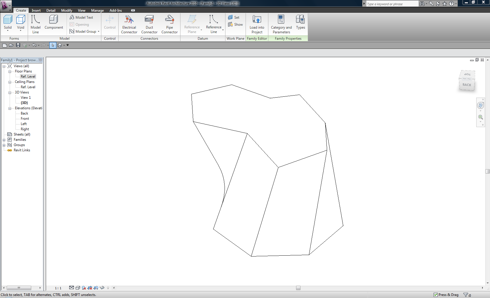

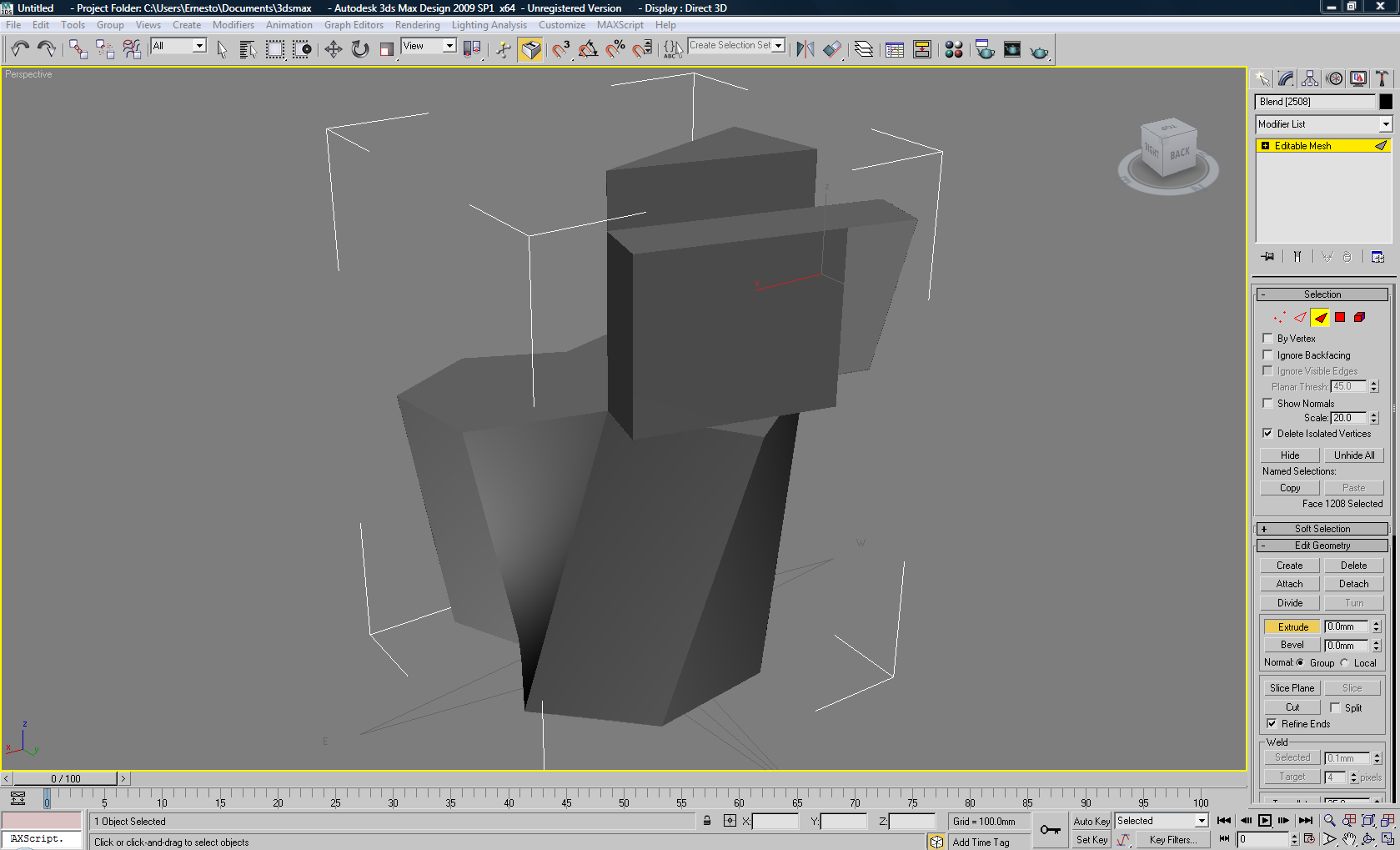

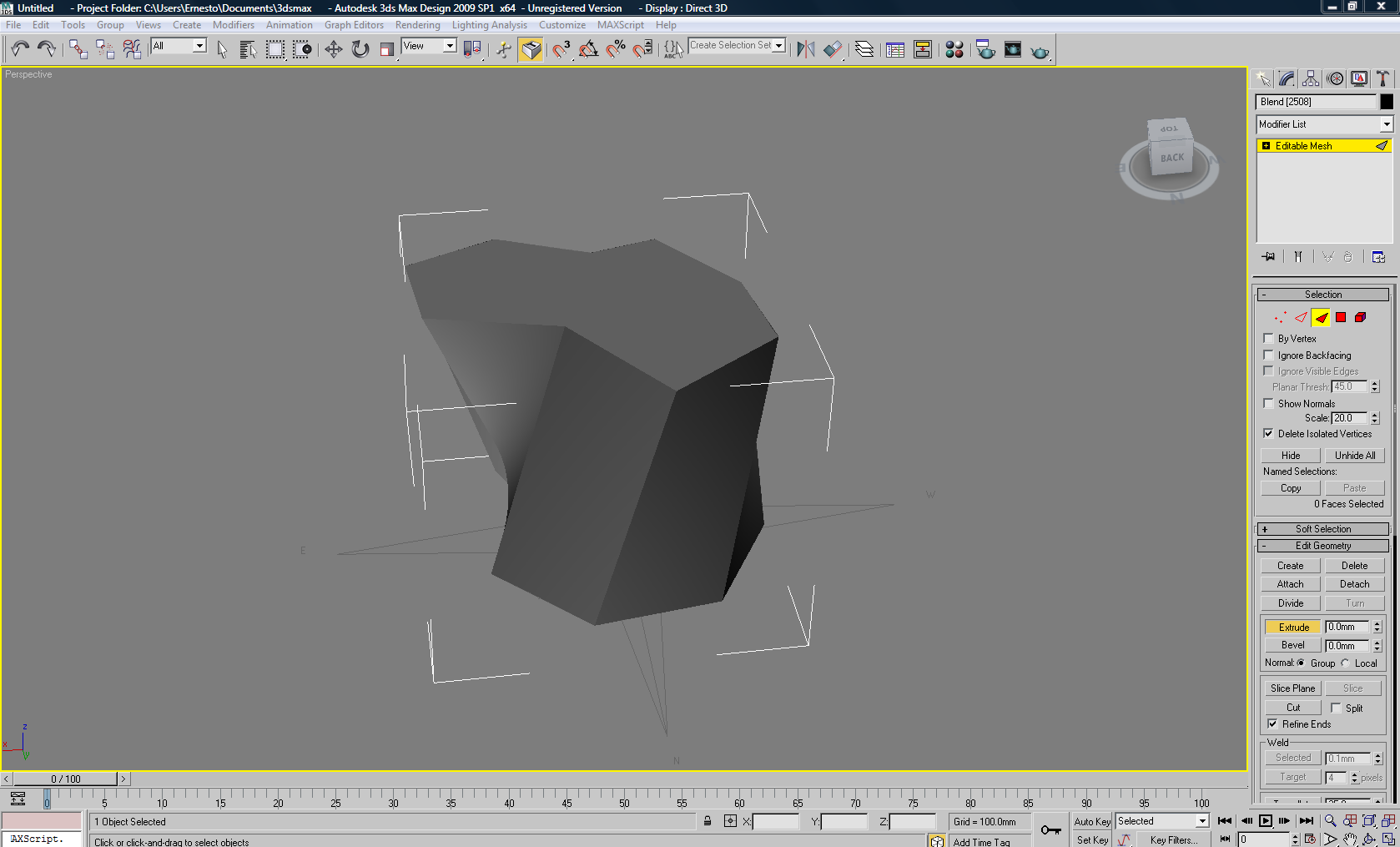

Maybe we don't fully understand your point, but Revit Architecture is designed to provide a high degree of interoperability with 3ds Max. " I have been told this is necessary for the file's final trip into Studio max which (apparently) cannot handle families." Of course not the way that Revit does it, (talking about parametrics), but it doesn't mean you can't modify them because you can (if you convert it to an editable poly or mesh). I.e. I made this mass using the Generic Model template (of course, it means it's a family) and then I exported it as .FBX. Notice that I can modify it in 3ds Max......
