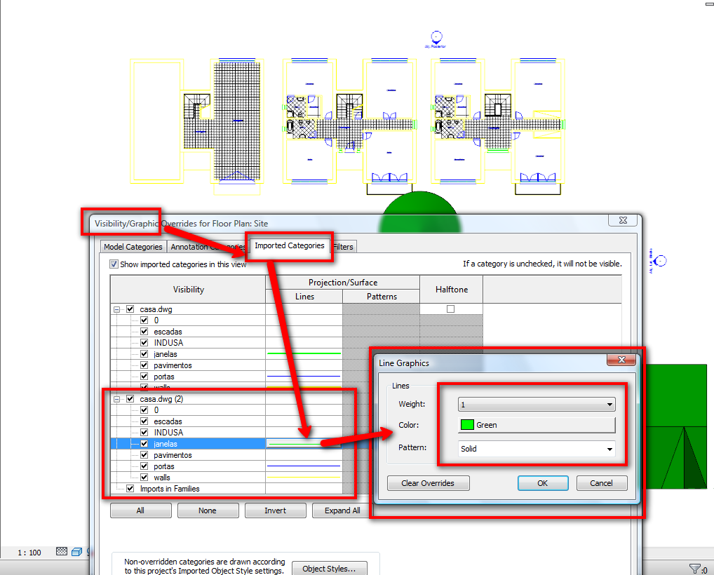

Hello,
I was wondering if there was a way to change the colors of an already existing linked CAD file in Revit.  I know that when you first link a CAD file in Revit, there is an option on the bottom to choose either black and white, preserve, or inverted colors.  Right now I have a file that is B/W and I want it to show up as inverted colors.  If there is a way let me know! Thanks.

Type VG, and follow the arrows.... see the image attached
