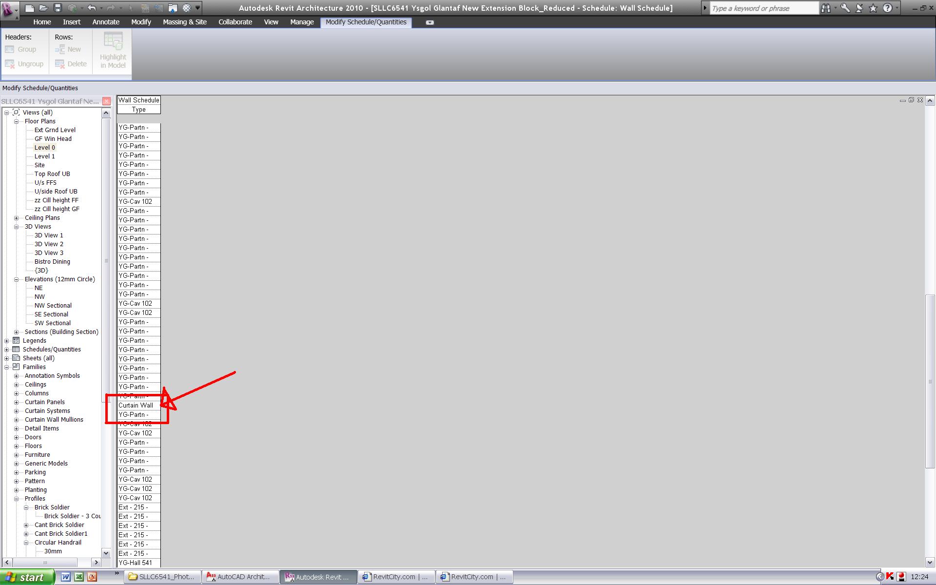

Create a Wall legend, your curtain wall automatically will appear

I THINK THAT DOESNT WORK...AT LEAST NOT FOR ME...what youv showed at the attached image is a schedule not a legend... i need to see on a sheet all the elevation views of my curtain walls but if a try to do it by a legend...the legend doesnt allow me to put a curtain wall in elevation, just in floor plan or section...check this thread...it seems there`s a solution but i dont get it...
