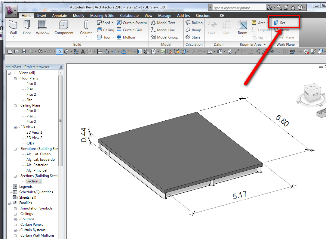

I have created a isomteric view of a stone still.  I used the orient to view command to create my view.  Now i would like to dimension the stone sill but when i do this it creates the dimension off in space no wheree close to where i am dimensioning or the faces, points or edges of what i am dimensioning.  Anyone have this problem or solved this problem?
 Oh yeah working in Revit Architecture2010.

First select the "Work plane" you want to create the horizontal dimensions, then choose another "Work plane" for the vertical dimensions.

Typhoon that worked like a charm.  Setting the right work plane to go with the right dimensions (vertical and horizontal) was a little tricky but it looks great. thanks,
