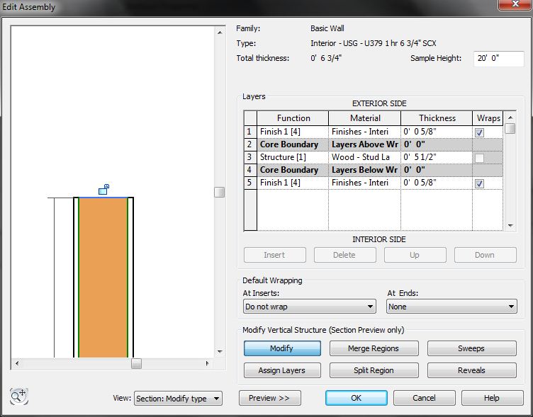

Ok, i'm attempting to modify my wall extensions, but no matter what wall type i try, i still get no shape handles, or am I able to do this in a different project. Please Help!

What i mean is that, i know you can say extend the stud layer past a floor, and have the gypsum board stop at the top of the floor level. My problem is that when i go to Wall-Type-Edit-Section and unlocking/locking layers, for some reason i cant get the wall layers to be separate heights

Hammer, are you trying to unlock the layers in the both sides of the "Core"? You can't, only one side is allowed... check that...
Tue, Feb 16, 2010 at 1:52:57 PM | wall extensions not working
Only adjacent layers can be un-locked.  If you need the exterior layers un-locked... think out -of-the-box.... unlock all the inner layers, set the wall to the height of the outer layers and pull all the inner layers up.

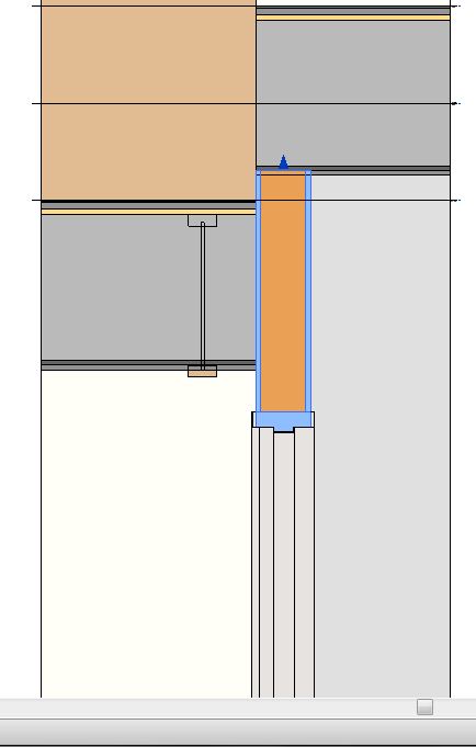

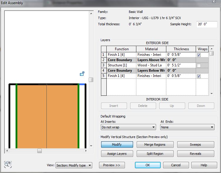

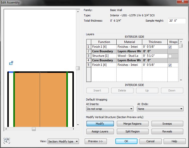

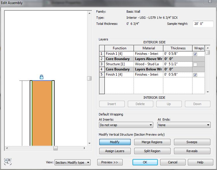

Ok, well heres the pics for you guys, and btw im using RAC 2010, and the USG walls

Hammer ... first - you have to be in section to adjust a layer.  The wall section you show should would work, if the wall is one that has a layer unlocked.  The wall shown in this section does not because it has only one adjustment arrow.
If you have the next to the last wall you show that has the core unlocked, you will have three arrows.  Either of the two outside ones will pull everything up or down but the middle one will only adjust the core up and down.
The two first ones will have only two arrows.  One will adjust everything but the single skin will only adjust the one skin.

o, well there all the same wall, but i cant the adjustment handles to show up at all. And i've tried it in different projects

You have all the layers unlocked and so they all move at once.  Either unlock one face or the other or don't unlock the faces - just unlock the core.  Try that - relock the faces and see what happens.....

Ok, did that and that solved my issue. Thanks.
