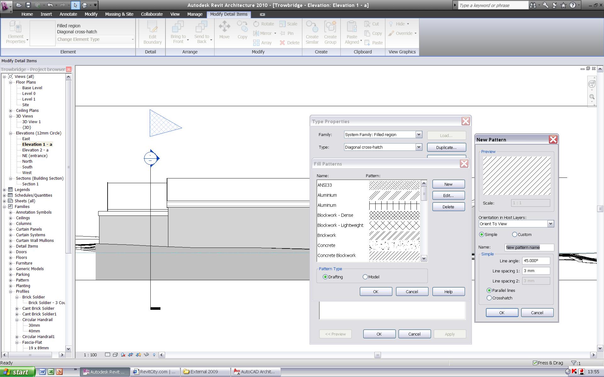

I've been looking and looking for a simple earth hatch pattern.  The one on here is at a 45 degree angle.
 Also, how does one import hatch patterns from CAD?

Image below shows how to make a new one, just click on new when you into your reigon properties.
I made an annotation reigon and editing the properties in there as shown.
If you press custom you can import a .pat fileso if you can get CAD to save in .pat you can import a hatch from there

hmmm i had added an image (try again)

Thanks, guys.  However, I'm still stuck.
 I read through the instructions from HELP, but it doesn't quite answer what I need, although very informative.  I have configured a pattern, but it's in txt. format.  I'm trying to figure out how to convert it to .pat format.  And yes, I've looked through the forum.
 I even downloaded hatchkit and I'm facing difficulty using that program, although it creates the .pat files.

Specify "All Files" in the "Save As Type" field (that's the field below where you specify the filename) to avoid MS Notepad adding  .TXT to the saved filename. If you specify the  filename to be XYZ.PAT without selecting "All Files", Notepad will save the file you just named as XYZ.PAT with a ".txt" filename extension so you wind up saving the file as as XYZ.PAT.txt    - it's right up there as Notepad's most irritating quirk.

HUGH!!!!  you made my day!!!
 i was getting so frustrated that i  couldn't get a pat file when i did a 'save as" in notepad, although i edited in a pat file.
Another roundabout way I did this was that I copied the pat file in a different folder.  Deleted the information in there and pasted in my new information.  I saved it, without doing a "Save As."  Then after closing the folder, I renamed it.
