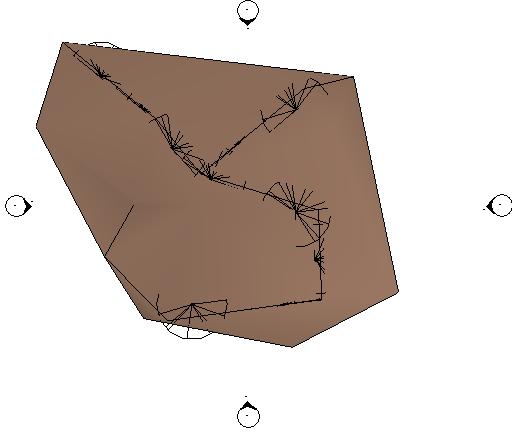

Is there a way to hide the topo lines underneath trees and other vegetation families in site plans other than taking the finished pdf into illustrator?

Typhoo i think he means that planting are transparent on plan of that the topo lines cut through them
 My only suggestion is to edit your tree and plant family and place a tree shaped profile above it, and have it hidden in certain views (like how the furniture families tend to work so they appear white on plan even with a legend)

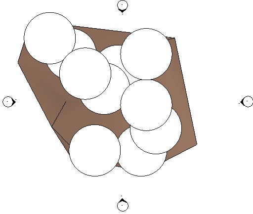

here, by editing my tree and putting a masking reigon at 'reference plane:top'I have made a simple cover for my trees, if you put more detail in, you can get the desired effect you're after

you dont make a new level
select your tree, press edit
in the family files just draw a mask reigon over your tree and make sure it's reference is reference:top
