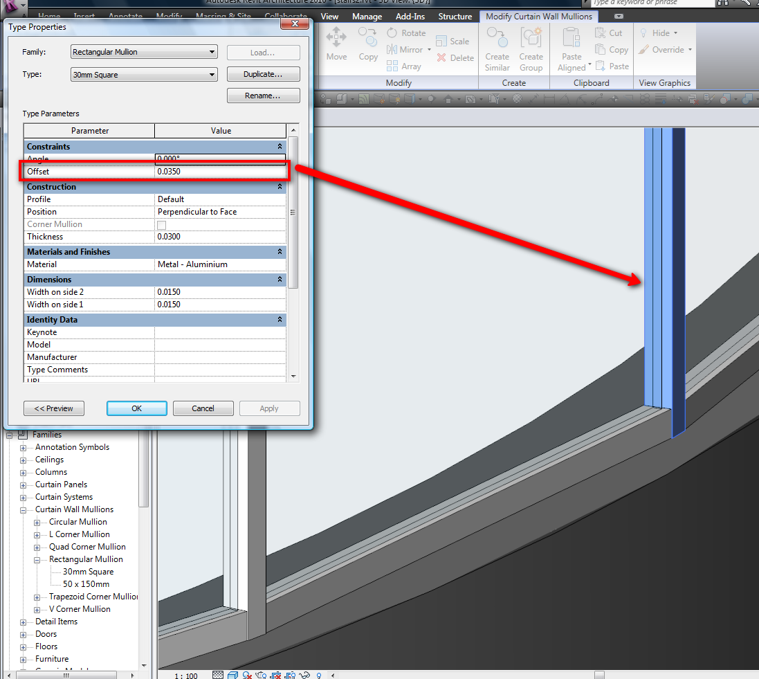

I'm having trouble attaching a mullion border to an exterior curtain wall, when I choose to insert the mullion on the "entire grid line" of the
glazing, this grid line is an arbitrary line offset from the middle of the glass placing the mullion offset from the glass showing the glass as hanging off of
the mullion.  Any ideas?

Surely,  this is a picture of the bottom corner of the problem:

Being the weekend I dont have access to revit to have a play, but my only suggestion is to go into element properties and select border mullions in the grid pattern options and see if that stops your problem as opposed to manually placing it
Either that or edit the mullion family and offset the profile off the reference line to the place you want it as save it as a speretate file

"Either that or edit the mullion family and offset the profile off the reference line to the place you want it as save it as a speretate file" - Do that Pdalt23 like Kardiff said....

That worked perfectly.  Thanks
