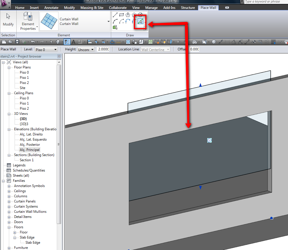

Like you can see by the image you have that option in 2010, in 2009 you select 2 lines or 2 edges to create that.. in 2010 it's a little different, you only select 1 line or edge, i prefer the OLD method (2009) but in this way we have a little more work to do....

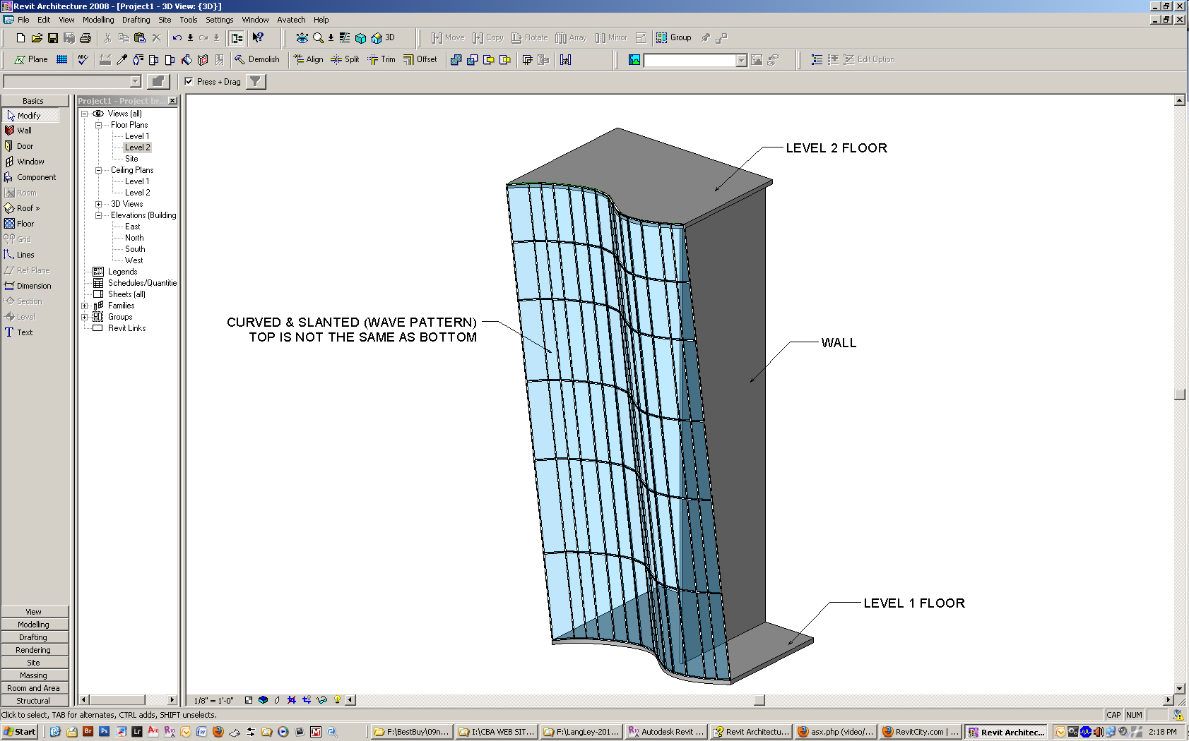

if i may reiterate on the OP's question. is there a way to select 2 model lines (say from different levels), to blend the 2 edges together to create an irregular shaped curtain system.
this curtain system by lines option was available with 2008, is there a way to do this with 2010?
see attached image for an example. this image was done in 2008. i'd like to be able to do this in 2010.
i don't think it was a very smart move if this option was removed from the new versions of revit.
