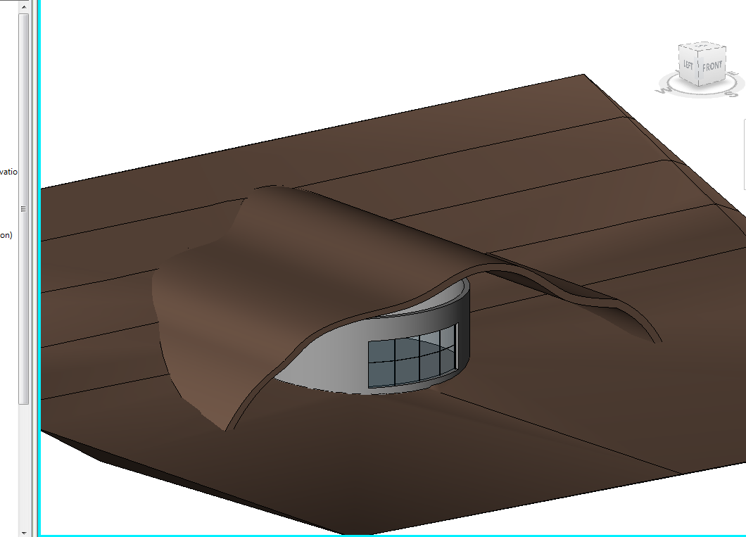

i've got a project that Im working on that cuts in and out of a steep hillside where in some places I would like for the topography to cover the building
(roof and walls). I've got my building pads in the places that i want but is there a way to achieve the above effect?
Thanks,
-P

After you create the Pads and if you really need to create that effect (cover the building) use the "Create-in-place" in the "Site" category to do that...
