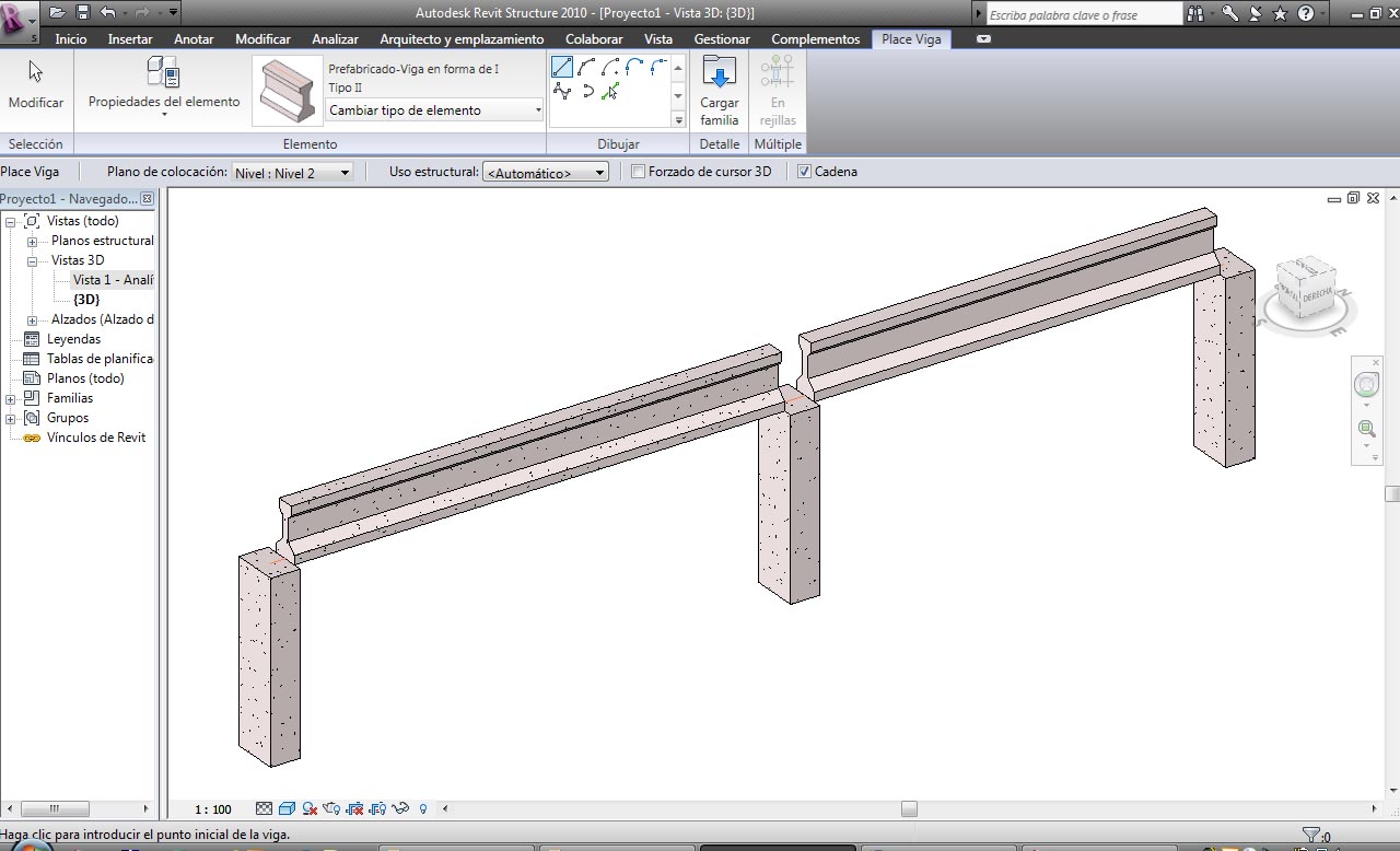

Hi,this is driving me crazy. It couldn't be so difficult.Ok, let's go. I'm drawing a simple porch, that is, three columns and a pair of beams. (from the library, rectangular precast columns and I-shaped beams)Start and end extensions are set to 0 at beam's configuration... how can I get the beams sit on the columns?Thanks!!!

If you go to your level plan and highlight your beam tere will be 2 blue arrows at either enddrag them to their desired place to change the beam to it sits on the column

Ok, this seems to work, but the only way to do it is modifying one by one?
