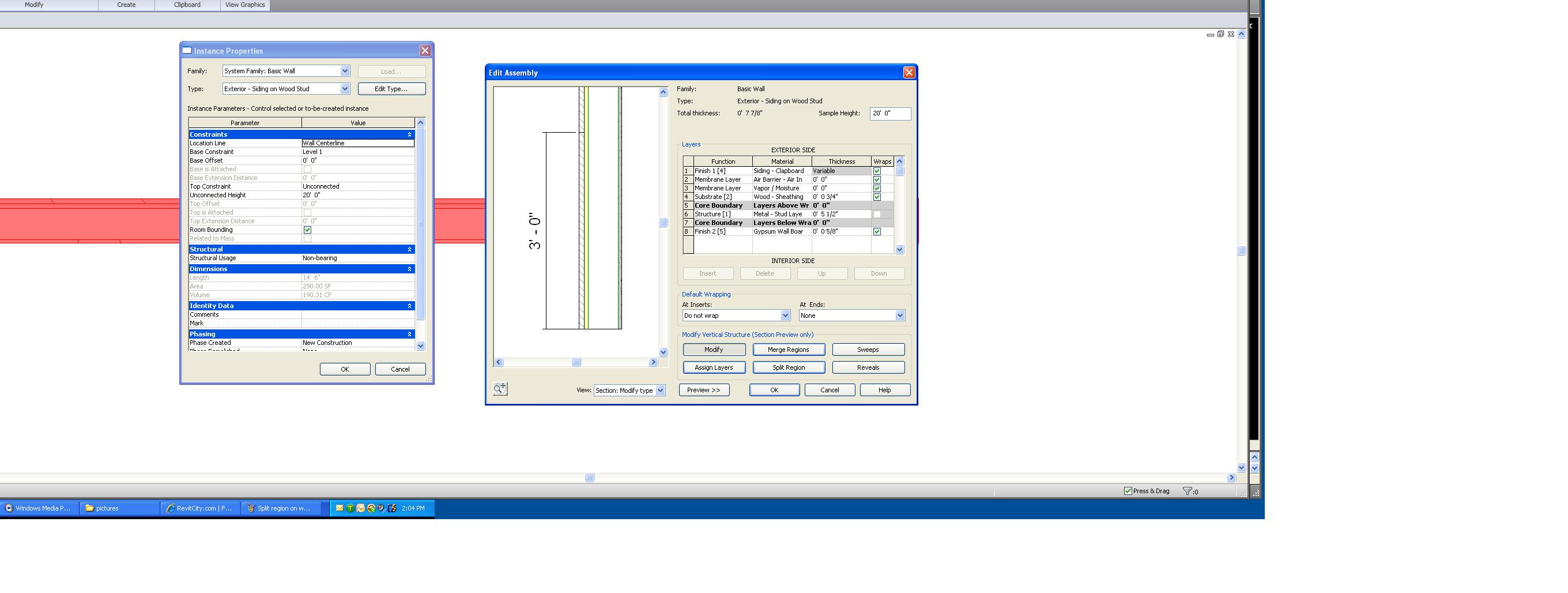

I am trying to split the surface on a wall to create a brick wainscot.  As you can see from the attached screen shot I have split the region, the exterior finish material.  I want to  make the material below the split brick with a different thickness.  Does anyone know how to do this?  Is it easier to do it with a stacked wall?  I thought this was the easy way to do it.
Any help will be appreciated,
Thank you,
AAron

I'm pretty sure that if you split regions on a wall, the thickness of the material will be the same for each region.  I usually make walls like this by creating a stack wall with the brick wall type on the bottom, then whatever type of wall on the top.  You can stack a few different wall types to get the varying brick thickness or use sweeps and reveals if it is only sections that are of varying thickness'
