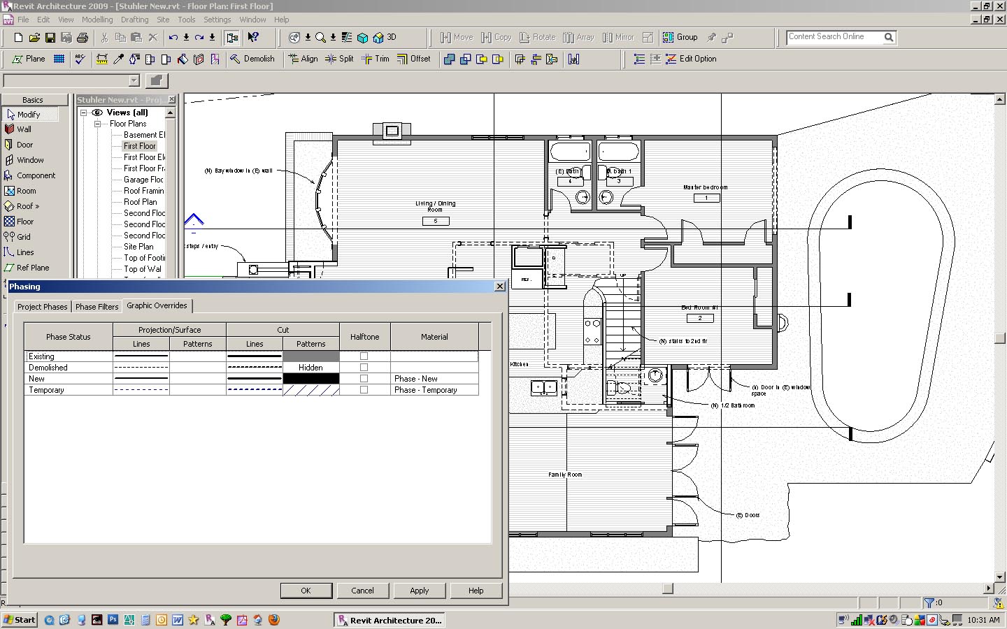

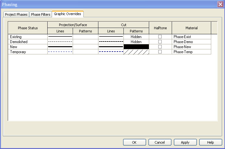

Go to Manage and select Phases.  You can use filters and graphic overides to achieve what you want.  See attached screen shots:

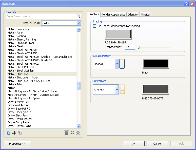

Make sure your phase in the phase for the view you are working on is not set to Project Completion.  Sometimes that will mess it up.  The other thing I did was to set the material for our metal studs to a solid material that was gray.  It will show up on the New Construction phase as a grey tone, but not show up on existing walls.  Hopefully I am understanding what you are asking and not frustrating you even more.

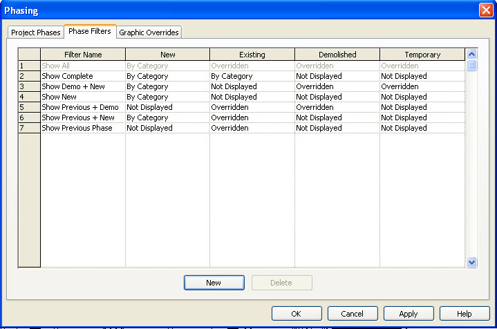

Thanks for the last reply. I have tried that with the material itself being shaded. but just wanted this to work, so your image helped me out though.
It was in the first part of the Phase filters. you have to make sure that it says "overridden" in the phase under the "new" column so that when you DO go into the visibility/graphics box the changes you make take effect. otherwise it still will defer to the "catergory" if thats what it says in the phase filter itself. SO thats how its done. your double screen shot showing both dialog boxes helped a little more than my single window of the VG dialog box.
