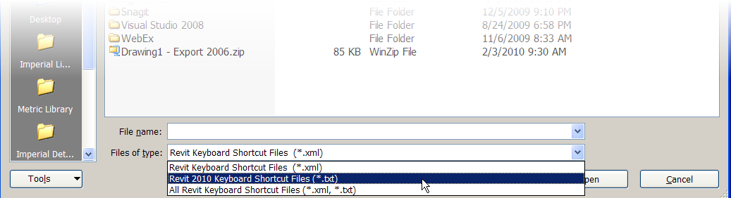

Sounds like someone installed the Subscription Release Pack for Revit 2010 on your system that came out last fall.  Their are several advantages to being able to edit your shortcuts in the dialog.  One of which, is the ability to import your existing, customized keyboard shortcut file.  In the bottom left of the dialog, click the Import button to load your customized shortcut file.  In the browse dialog, change the file type to be imported to Revit 2010 Keyboard Shortcut Files (*.txt) and you are in business.  Once you have your custom keyboard shortcuts in the dialog, you can continue to modify the shortcuts in the dialog. There were other features of the Subscription Release Pack you might want to look into as well.  I've attached a doc that describes them.

Hello, With the Subscription Pack installed, your Revit product is now ignoring your external keyboardshortcut.txt file.  It is no longer required.  Your keyboard shortcut settings are now being stored within the program just like other settings such as Dimension Styles, Text Styles, Object Styles, etc.   The external keyboardshortcut.txt file is no longer used by the program but, because it is still available you can import your custom settings from it into the product through the new dialog.
I have found it much faster to edit the shortcuts in the dialog since I don't have to navigate to an external file, perform the correct editing procedure like removing a semicolon, adding or not adding quotations, save the file, leave Revit and reload Revit to verify whether the shortcuts actually work.  With the dialog, I can just select the command I want a shortcut for in the dialog, type in the keys I wish to use and hit the Assign button.  Done!  My macro is immediately available.  This is a good thing!
