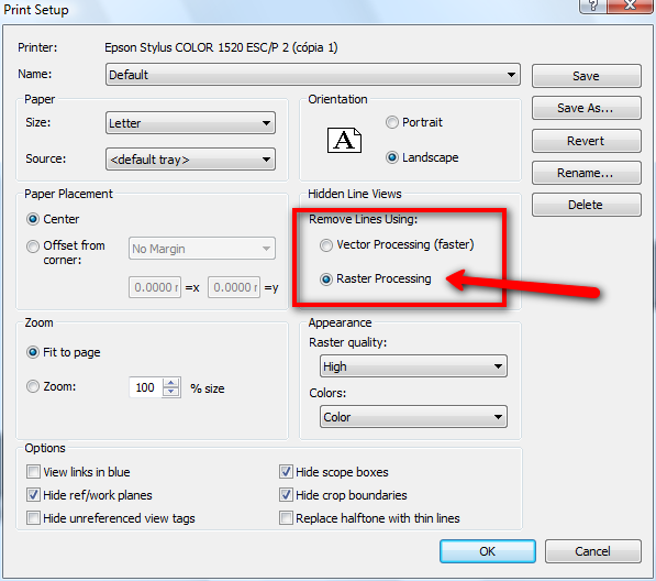

i encounter this wierd problem with revit just 2 days ago and im completely lost. done with the lay out on sheet of sections, mass is checked in visibility but when i print preview the sheet the mass disappear, and it is totally gone when printing but the wall and floor and componets were still there. need help please.

Wierd... try to print in "Raster Processing"....
