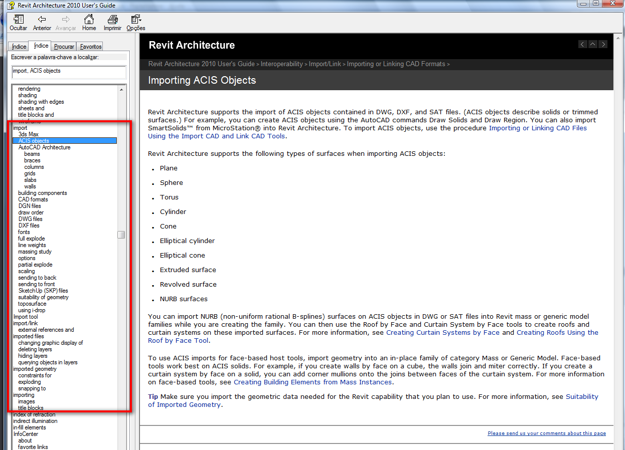

What kind of families do you want to create in Revit with those DWG files? You must understand one thing, when you insert DWG or SKP (sketchup) files into a Revit family they are "Dumb" objects, they aren't parametric, you can only apply materials on it IF you follow some rules... Check the HELP menu for that....
