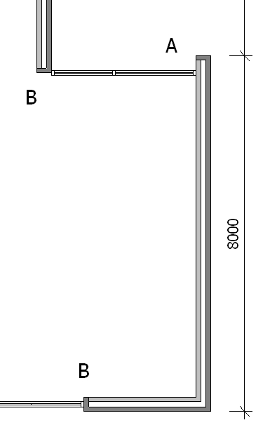

Is it possible to have al wall wrap at one end and not wrap at the other end? In the attached picture I want the wall to wrap at point A and not wrap at points B. Embedding the curtain wall in the other wall could give a solution for one point but not for the other.
Thu, Feb 4, 2010 at 8:52:22 AM | wall wrap
If the end of the CW at that point is set not to join and if the wall is set not to wrap at inserts - you will get what you want.
