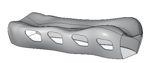

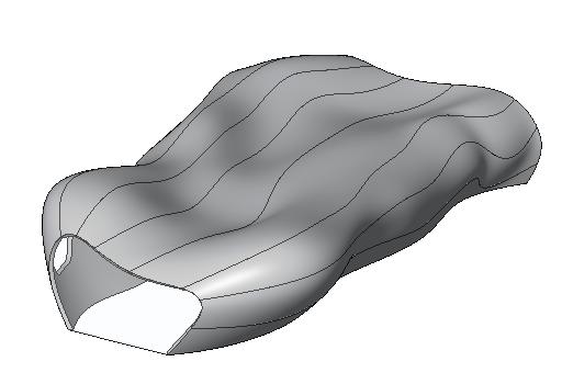

Im busy exploring the possibility of doing an organic design in revit 2010 whereas i would usually stick to modeling it in MAX.
The only problem i have at the moment is the openings. I started off with a free form mass and made walls by faces. Then made openings by using a generic wall based fam. NOW, the Q is, how do i make a window frame and glazing etc to fit the opening. The glazing will obviously have to be faceted i.e. a curtain system, but how will I get the opening and the curtain system to coincide and still accomodate changes?
The attached images is just a quick 30min test (its not the design!!!!!! haha) I'll try get permission from the client to post the design images, but hes pretty secretive and wants to keep a very low profile.
Thx in advance peeps!

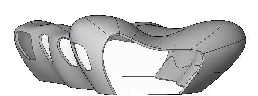

Geometry works like in every modelling program. You can make sweeps, but you need to define rails, and profiles.
You can make an extrusion, if you define a profile, and a line to host it.
You can make a Bolean substraction, only if you have a main object, and a intersected object to substract (void).
You can make a loft, if you have some profiles to describe the changes of the loft.
You can make a revolution, if you have an axis and a profile. Thats all.
You can describe almost everything with those. And the original question was, how to cut holes on a loft? >_> well, you can do the loft in several ways, i do it with an adaptive component as a profile, hosted in new elevation planes ( you can add more planes clicking on create planes, and with the plan plane as host),
then i choose all the profiles, and click "creategeometry". After that, on plan view i create a rectangle, create a void from it, and cut the loft. Tadaaah xD
i add a sample to that original question. The procedures are on youtube, or in revittod.co, but you have to imagine the solution to the geometry.
