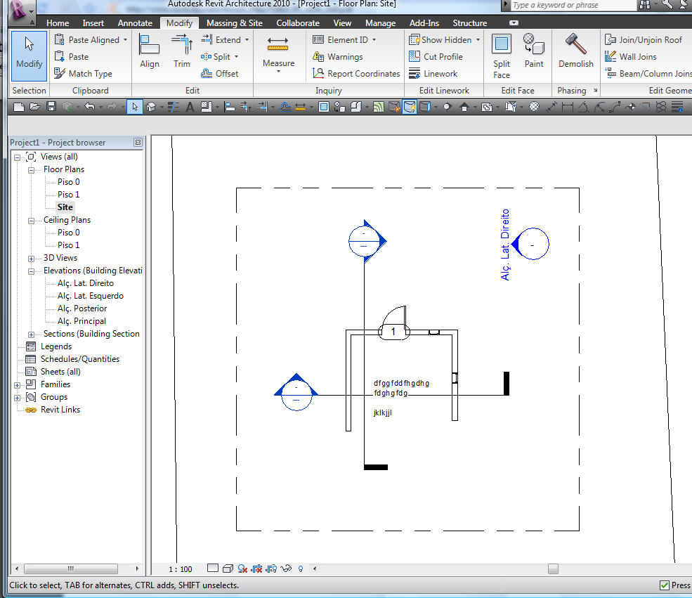

I am working with revit 2010.  I recently attempted to add a property line to a model to create a site plan.  When I did this, almost everything in the model vanished.  Some text stayed behind and a few traces of some model elements but otherwise it was all gone.  When I delete the PL, it all comes back.  It's as if the PL is covering the model.  I am still quite new with some of revits functions this being one.  I have gone through every properties dialogue window I can find, I have tried changing levels, and on and on but nothing seems to work.  I have put the property lines in other models with no trouble at all.  I am totaly lost and a little desperate.
 Anyone have some solutions?!!!

Without having the model, I can only speculate as to what you may be doing, but I bet you have added a topo surface that is above most of your model elements.  Might want to spin your 3D model and take a look - even upside down.

Solved the problem, delete the plan (site) en create a new plan site...and it shows the boundery line and model correct

I had this happen to a view once, though I attributed the problems to turning on 3d acceleration in the graphics options.
