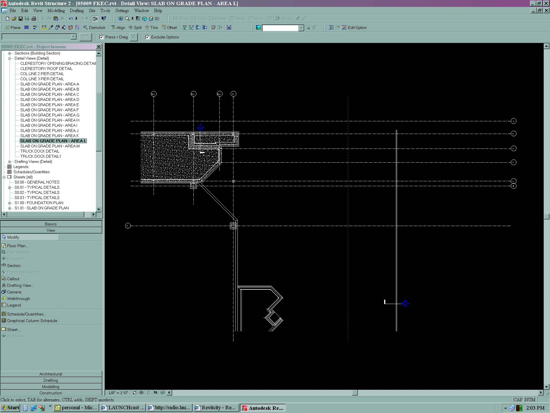

I have a problem. i have a concrete showing up on my slab, when I create a detail of the plan. when I have the drawing at 1/8" scale or larger the hatch shows up, when it is at a smaller scale the hach doesn't. what causes this?

nevermid figuired it out. i would like to know what causes that. i found a work around (overriding the detail levels for slab, and turning off slab edge).
