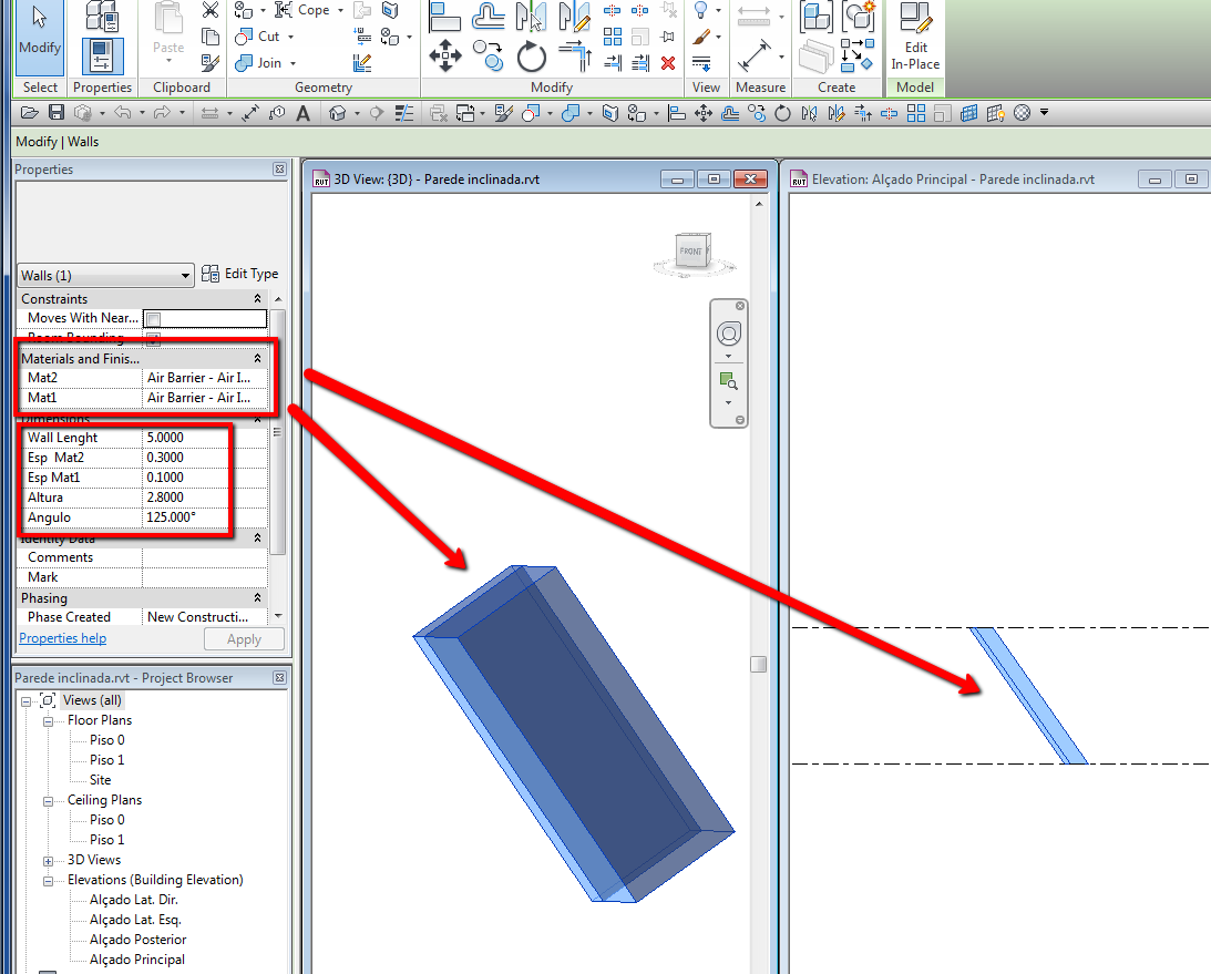

Simple, create SEVERAL parts (layers) like you want/need with different materials, watch image attached (just an example)
