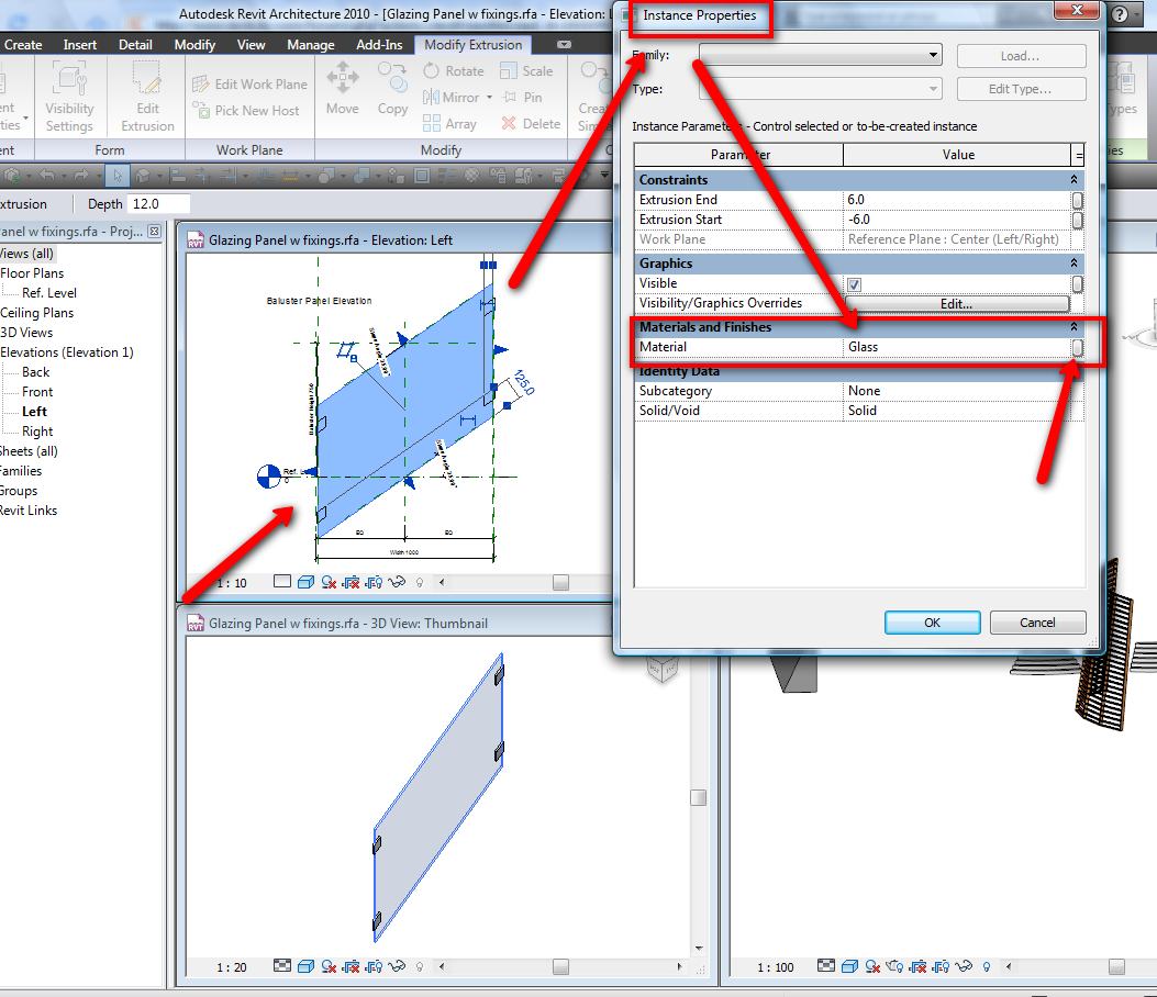

 Just wondering if someone could help out here. Ive just started using Revit 2010, still trying to get my head around it. I'm stumped on trying to change the colour of the glass panels in some railings(the ones in Revit metric library). Cant seem be able to edit the panels??? Anyone know how??

Open that family, pick in the panel and go to the properties, in there you can see what material (name) you have to that panel (glass), so in project go to materials and change that material, but in that little right button (like you can see in the image i attached), if you pick you can add a parameter to create a new material name if you want...
