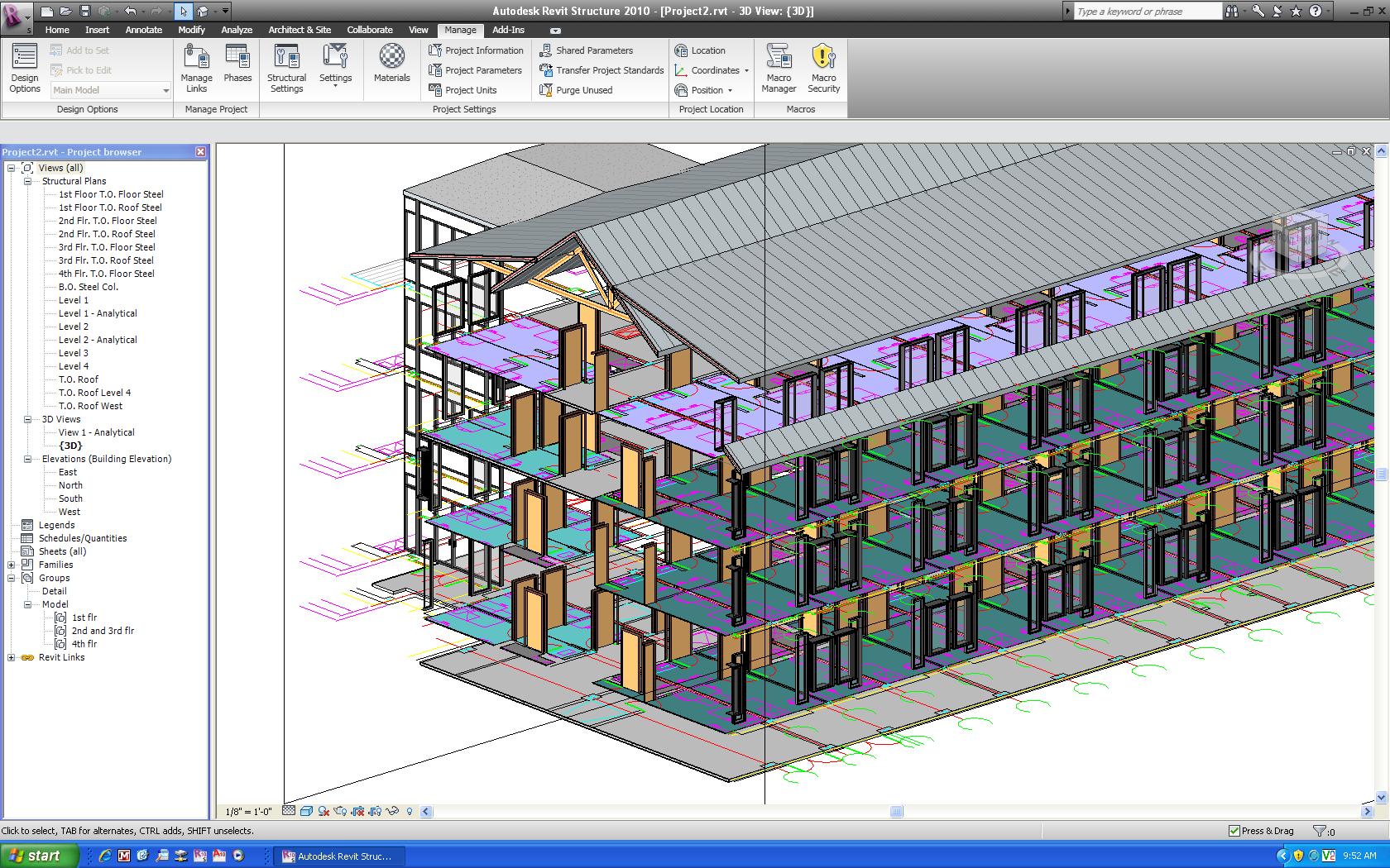

Cannot see arch object when model is linked into revit structure from revit arch. Is there a way to see there none structural items when their model is linked into revit structure?

i can only see floor outlines, some windows and doors, and roof truss in all views i have gone and turned every thing on in the the vg.  There are no structural items in our model to hide there and when i click the light bulb to show hidden items you can not see them there either.
and There are no phases to the drawings

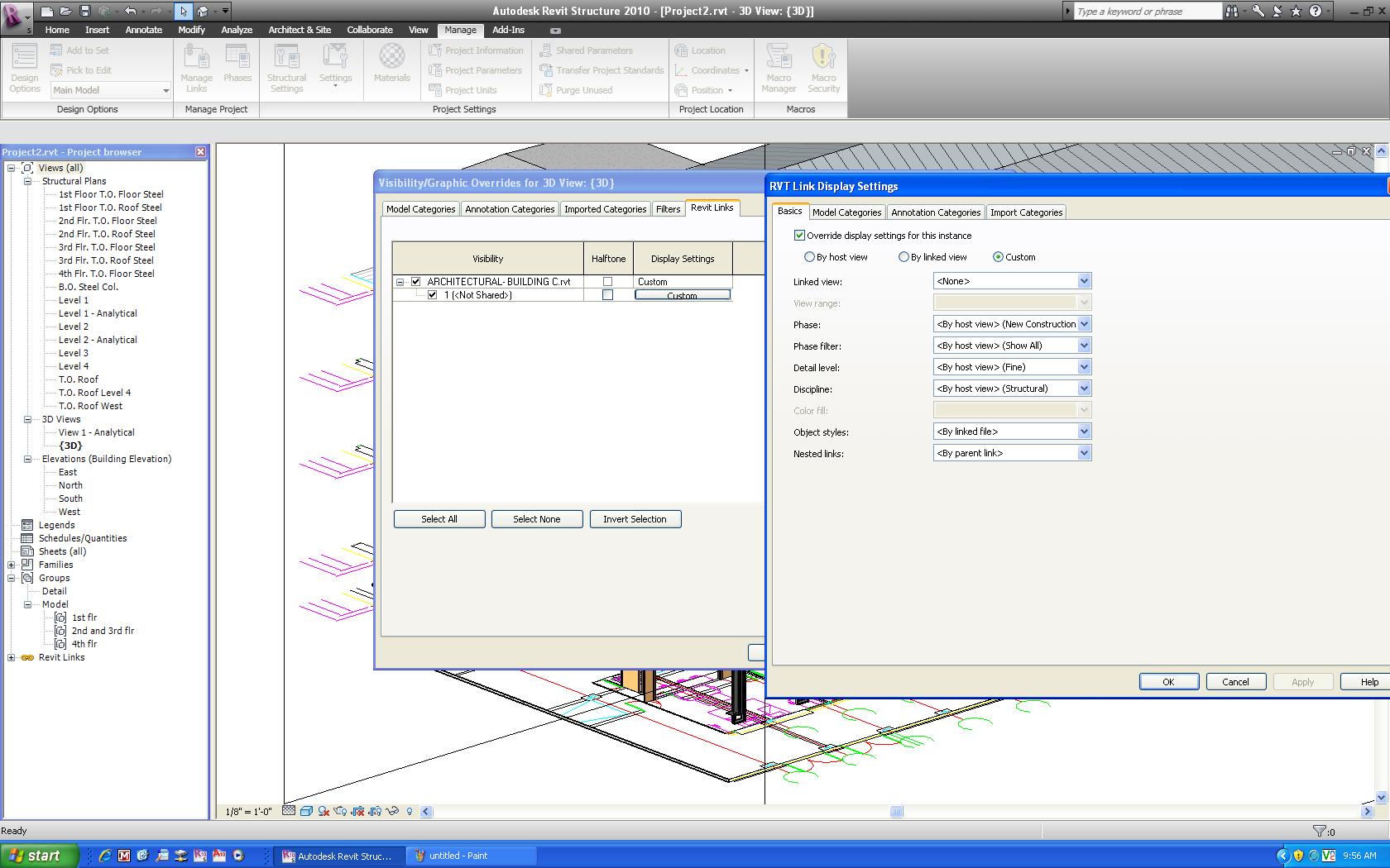

Create some screen images (screen hunter is free) of your settings. Include one of your plan VG - model categories, then from that VG the tab for the revit link and then click on the display settings there and give us a shot of the Model categories tab in the Revit Link.

Have you tried setting the view discipline to "coordination" instead of "structural"?  Others have mentioned checking the visibility graphics settings.  Have you turned everything on from all disciplines?
As WWHub said, some screen caps would help us help you.

We need to see the next image.  For both link elements, you have it set to custom so show us what the custom VG settings are.  I also see that the phase filter for the link is set to show all, you might try show complete.

thanks for your help.. it was i had to change the view discipline to "coordination" from "structural"
