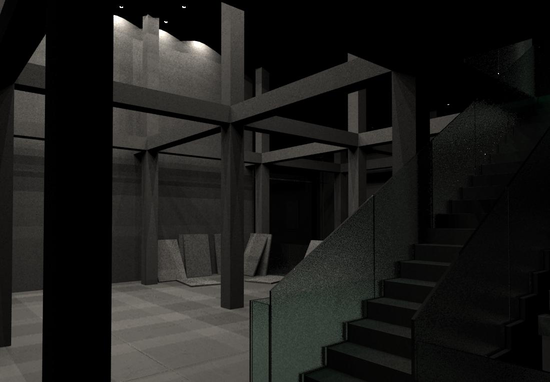

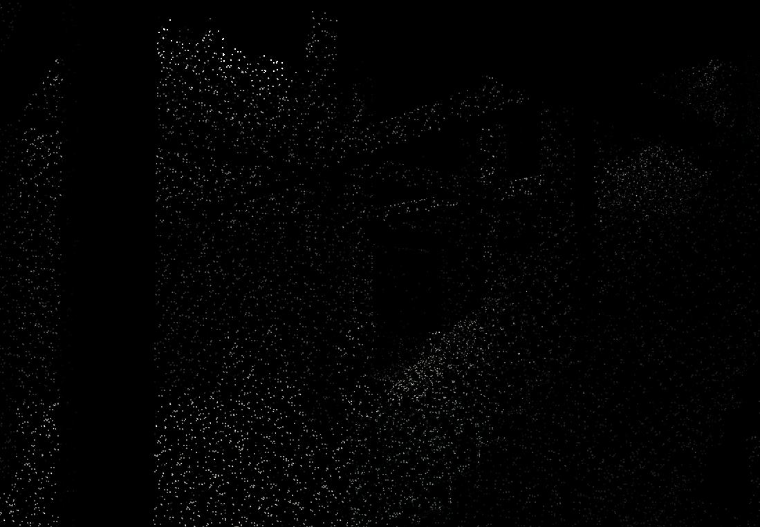

Hi guys. I'm rendering an interior scene with lots of spot lights (around 70). The light fixture family is downloaded from here and modified (I removed the luminous material, kept the light and switched it from point to area and from spherical to hemispherical). When I render the scene with hard shadows it renders fine, but when I enable soft shadows, even if I cut the number of fixtures by half or more, it's excessively dark and looks just plain wrong. The whole scene was made on RAC 2010 stock, and I installed Update 2 before modifying and adding the light fixtures.I attached the renders. Global Illumination is off for increased rendering speed. The only difference between the two is the enabling of soft shadows.

I almost forgot, in order to see anything in the second image (the bad rendering), I had to change the exposure value to 5, otherwise it looked almost completely black.

I managed to sort it out eventually, apparently I screwed something up when I edited the family, because the original works just fine, and so do other families.One of the reasons I edited the family in the first place was to replace the casing, because although it was a revolve, it looked squarish (faceted), like an old low-poly model. If I create a new revolve, sweep, extrusion, it all turns up the same (not rounded). It's quite annoying and I don't know what to do about it. It affects the shadows too and it's much more visible there.
