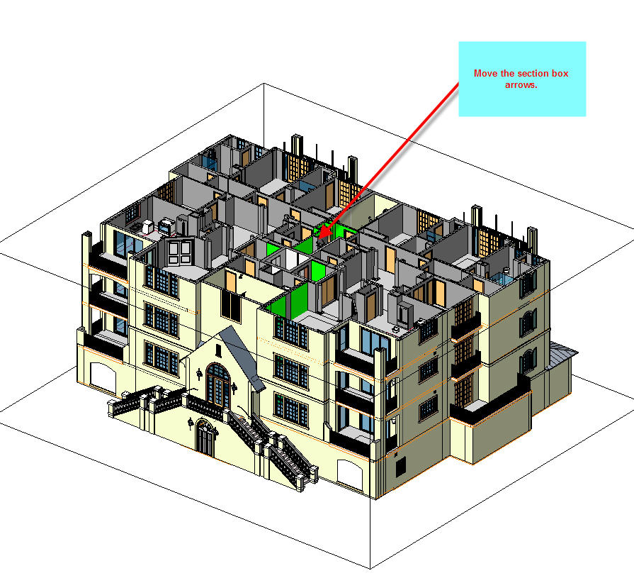

You can try the section box under properties or if you break your file into worksets you can do a level 1 and level 2 workset and turn off the workset you don't want to see.

Thank you for your input. I must admit that im still lost :-) I can check/uncheck the section box without any visible result in the 3D view. I imagine that there is supposed to be parameters somewhere, but i just dont find them. /Magnus

In 3D you can use the section box to clip the viewable portion of a 3D model; to see the clipping, When the section box is visible, you can resize it and rotate it with the handles (see jpg).

Thank you both for your input, I got the hang of it now. The speed of the answers where fantastic. Its really nice to know that there is a thriving and excellent community before making a purchase descision. /Magnus
