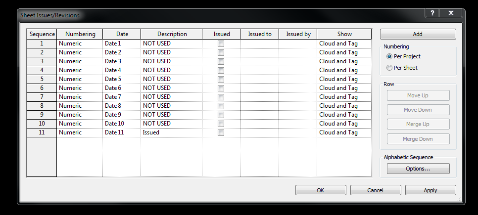

Is there a way to change the numeric sequence in revit for the revisions. When I use a numeric setting, it starts with 1. I would like it to start with zero.
We use alphabetical revisions for schematic design and numeric revisions for after permitting so I cannot fake it by using the letter "O"
I am using Revit Architecture 2010

If you open the "Sheet Issues/Revisions" dialog box, You can keep adding revisions till you get to the number you need to start on. Just lable all the extra revisions as "NOT USED"
This does not fix the revision zero issue though.
Tue, Apr 27, 2010 at 7:42:33 AM | Revision Numbers
James... You can do what you want.  Simple create and issue 16 revisions without doing any clouds. Then create #17 and when you add a cloud, the numbering should start w/ 17.

Actually...this is easily achieved with a little creativity.
The first revision needs to have its numbering sequence set to NONE. The rest of the revisions are set to NUMERIC.
Because the first revision does not have a sequencing convention it is left blank and because the second one is numeric it will start at number one when placed on a sheet...don't worry if the revision dialog says 2...it will show correctly on the sheet....the dialog just shows those for ordering purposes.
All that is left is to place a simple "0" on the sheet and you are done. If this shows on all sheets, then I would add the zero to the title block family and you will never have to worry about it again.
