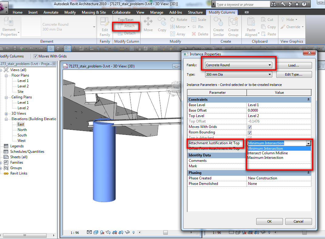

Does anyone know how to slope top of columns to suit underside of beam?
If I extend the top of the column past the intersection of the beam and the column, it cuts it off and looks nice.  But when the beam is not the same width of the column, it looks really goofy.
Can anybody help ?!

Check the HELP menu for this, maybe it help you to understand how it works...
