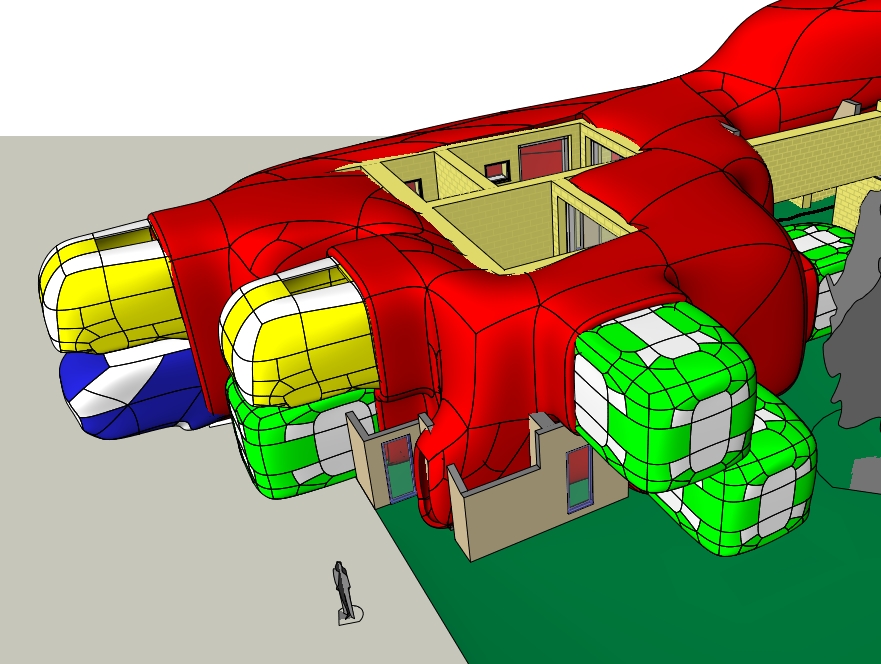

Thu, Jan 21, 2010 at 3:27:33 PM | Revit 2010 - How do I reduce file size?
LSMS
Joined: Wed, May 7, 2008
15 Posts
Part of the project.
