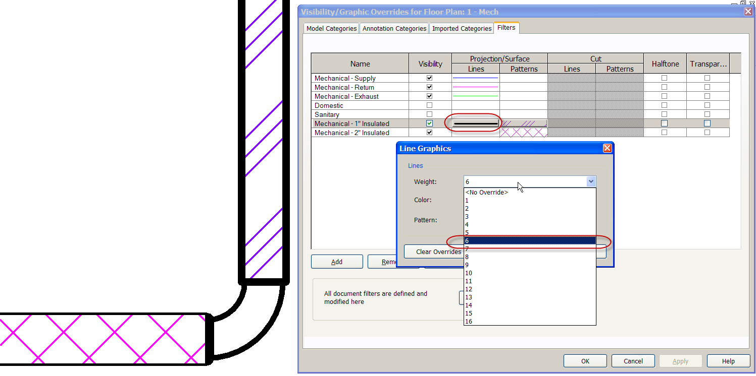

So i have hatched ducts to show diffrences between insulation thickness. i have done this by creating a filter and linking it to the diffrent ducts. this is all working fine, but when i want to change the line thickness (lineweight) of the hatch it is also changing the duct lineweight itself. Is there a way to avoid this? Or is there a better way to hatch ducts diffrently in the first place which wont cause this issue?
 I can get the duct line and the hatch line to appear as diffrent colours, but they still print the same thickness

Hello, I think you are almost there.  Take a look at adjusting the thickness of the lineweight in your insulation filter.  I boosted up the setting to 6 on one of the insulation filters I created to see the effect.  Notice the vertical piece of duct in the example below has a much thicker lineweight that the horizontal piece of duct.  By default, the duct itself is represented by a lineweight of 5, I haven't found a way to adjust the insulation lineweight. When using a Hidden Line view display we only see the skinny outer line of the insulation.  Changing its lineweight in your filters for various insulation thicknesses should solve your problem.
