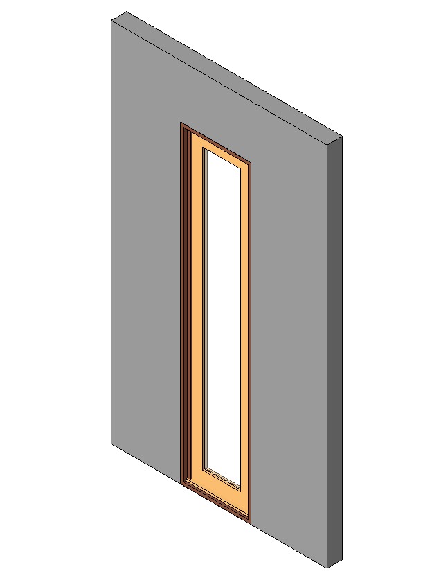

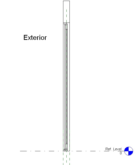

I have modified a window to fit my needs, and in doing so created an un-placable one. While editing, it looks fine in all views as far as I can tell, but after saving will no longer place in the wall.
If someone could take a look at it to see what I screwed up.

When I create a new door or window, I first establish some base reference planes. These planes I use to create the void space, in order to cut the hole in the wall you must tell the void space what to cut by selecting the wall. Create the void space first. When you create each of the objects of your window or door, you must lock them to the various reference planes, it is important to name these reference planes. With dimensions connecting these planes, and having added parameters to the dimensions which will fill in the dialogue box, you can move the planes around by changing the values for the various dimensions in the Family Types dialogue box. Hope this helps to get you on the correct path.
