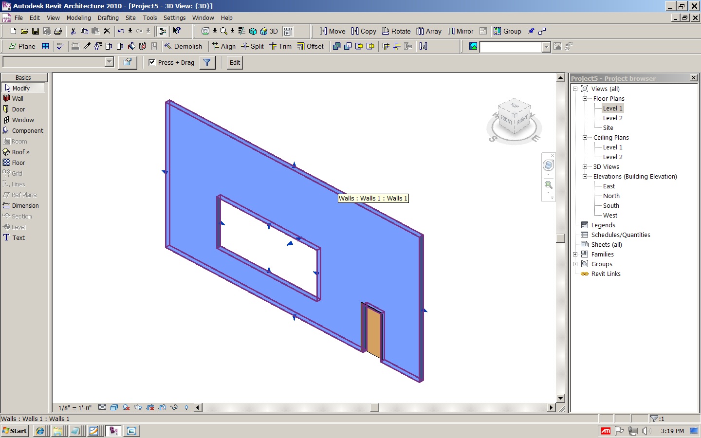

i think you are saying there are only "system" walls..
please see the wall i created that is NOT a system wall..
Mon, Jan 18, 2010 at 5:55:48 PM | wall family
mhans
Joined: Tue, Nov 7, 2006
456 Posts
3 Stars: 10 Votes
Yes, you can actually make an in place model and categorize it as a wall. But you cannot assign or tag combination of materials like you would in a system family wall. You can only assign Function & Identity data to your in-place wall model but cannot define its material/structural composition. And in an in-place wall, like your wall1, will not respond to trim, extend, split like a real wall. May I know your reason for trying to create your own wall assembly?

i'm thinking i can design any wall shape i want as an in-place family
wall and build a generic model that can more easily be modified
in a design stage.. and i'm wondering how that kind of model
can be converted to construction details when it is ready..
are you saying once you start with an in-place wall it can
never become a real wall?

In-Place Elements
Yes, you are right. You cannot convert an in-place wall to a system wall later on. There is no option to duplicate or match prop an in-place wall with another in-place wall. A system wall has more functionality like core face exterior/interior, base/top constraint, base offset, inserts/end wrapping, and the likes that are very helpful in changing wall types later on in the CD phase.
For schematics and DD, your in-place wall wil come in handy, but once you are itemizing your wall components, you will find yourself redrawing again those walls.
In-place elements are custom elements that you create in the context of a project. Create an in-place element when your project needs unique geometry that you do not expect to reuse or geometry that must maintain one or more relationships to other project geometry.

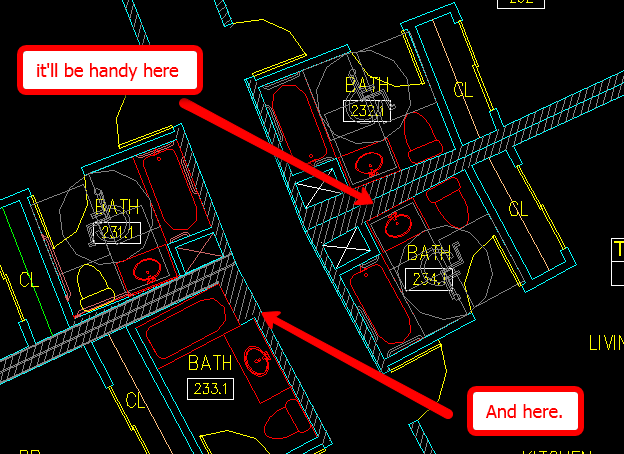

Pls. see attached for a generic sample. If you will be doing the CD too, system walls will later on give you more flexibility. If you're just presenting your ideas, your in-place wall will just be fine.
