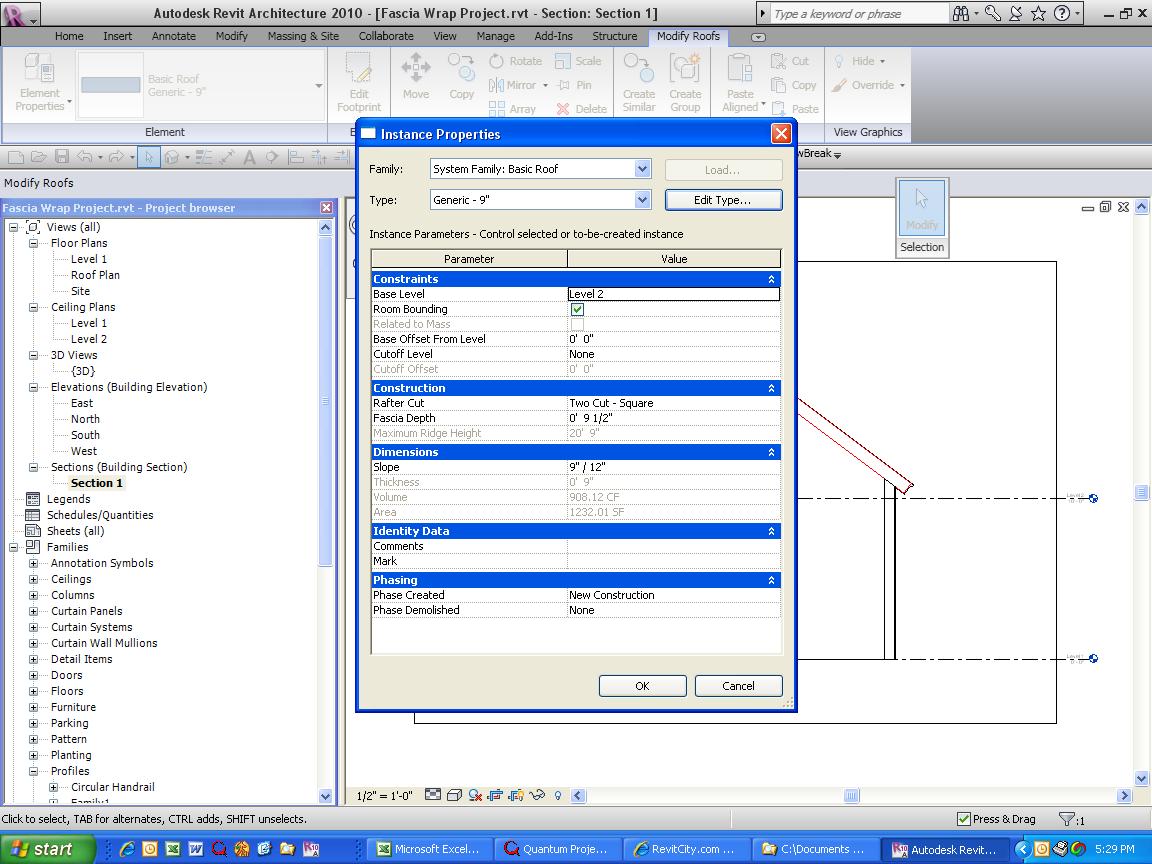

I worked up a sample project and fascia with crown.
Be sure to post your results. It helps others later on.
