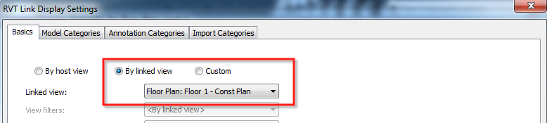

I have two buildings and have linked in one file to the other.  when I go to print the overall site plan the linked in file will not show the section markers.  I have checked the visibilty scale and it is set to the correct scale for the page.  I noticed under VV, that the linked files annotations, the sections checkbox is missing.  does anyone have a solution for getting the sections to show up across links?  Thanks.

When you link a Revit file in you can display either the linked model, or a specific view from the linked model.  If you want the sections and elevation tags to show up then you need to be sure to change the VG of the view to display a specific view of the link.

You didn't listen to what I said.  You can either display the linked model OR a LINKED VIEW from the link.
Revit is all about creating and managing views.  Develop a view in the model you are going to link it that displays the annotation you want to display.
Then go to VG and choose to display that developed linked view in your host model.
See the attached image.

Sorry my bad.  I though it had been implemented in 2011.  With 19 versions of Revit and their alpa and beta releases under my belt I sometimes get confused as to the current state of the program.
Autodesk in the 2011 release enabled more large project workflow features like tagging across linked files and scheduling of consultant sheets directly without the need for dummy sheets.  In the future hopefully they will expand to showing and referencing sections and elevations across links.
Meantime, the old standby work arounds are in play.
1.  Create a Section that references another view in the 'master' project.  Place that section onto a sheet with the same number as the one in the linked file and make sure it gets the same detail number.  [lots of work and potential for error]
2. Create a view in the linked file that isolates the section and elevation cuts you wish to display in the link.  Export this view as a CAD file, then link the CAD file into the Revit 'master' file.  Not 100% fool proof but the recommended method I would use.
