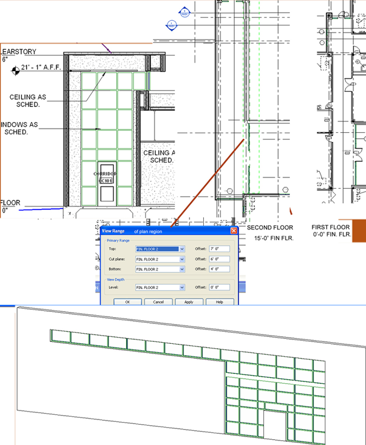

rEVIT 2010----i HAVE A LARGE WINDOW IN A PROJECT. THE WINDOW SHOWS CORRECTLY IN FIRST FLR PLAN BUT NOT IN SECOND FLR., IT STILL SHOWS LIKE IT DOES ON THE FIRST FLOOR VIEW. i HAVE USED A PLAN REGION AND SET THE VIEW RANGE TO THE CUT HIEGHT I NEED, BUT IT STILL SHOWS LIKE THE FIRST FLOOR VIEW. 2ND FLR=15'-0" AFF.
NOTE: THEN, I OPENED THE ACTUAL WINDOW FAMILY AND CHANGED THE VIEW RANGE TO THE HIEGT I NEED TO SHOW IN THE PROJECT, LOADED IT AND NOW IT SHOWS THE WAY I NEED IT ON THE SECOND FLR. BUT NOW ITS REVERSED. IT SHOWS WHAT IN NEED ON 2ND FLR. BUT ON 1ST FLR. .  HELP PLEASE

Have you built this window family to show symbollic linework instead of cutting model elements (model elements turned off in section)?  If so, then you will only see the symbollic linework.
window does not get cut in plan view.
