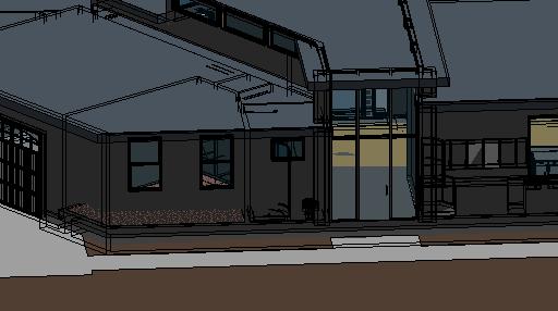

two days ago the exterior 3D view just started showing interior elements, partial wall lines. It is NOT in wireframe. all other three options ( hidden lines, shades, shades with edges) are showing it the same way. please take a look at the image. what happened?

Revit Version???? did you upgrade Revit with the Web Updates??? Delete that 3D view and create a new one....

I can explain this -- I was having trouble awhile back in two separate projects while using revit architecture 2009.  If you go to view properties, look for the "eye elevation" field.  It's not editable, but... does it say something like 57835724 feet?
I had my 3D view zoom itself out to further away than the MOON.   No exaggeration.   And it kept doing it over and over again through the simple process of spinning and panning.  Never found what was doing it, but the fix is this -- move your mouse to the upper right hand of the screen, by the view cube, and hit the little house.  resets the view.

thank you guys...I tired deleting the 3D view and getting a new one and worked out just fine...but i'm sure itsmyalterego was right too...
