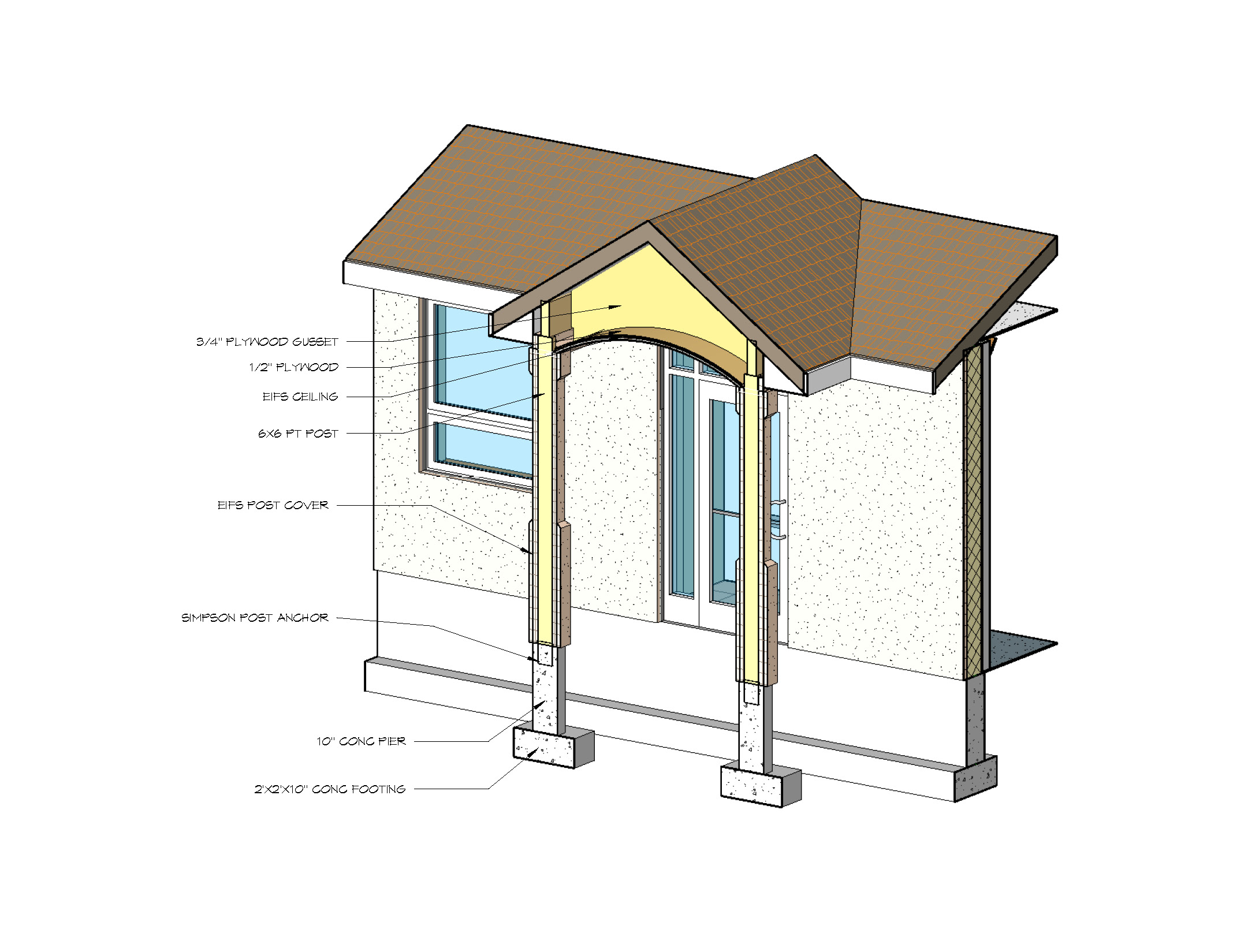

Here's a bit of an entry I've been working on that's part of a 14,000 square foot project with our new office renovation.
It includes:
Custom door, window, column, plywood gusset families.
A column hold down from Simpson Strong ties on line Revit Catalog (very well done by the way)
In place Soffit and EIFS extrusion for finish on entry.
Structural columns, beams, piers and footing. Got a tip from Mr. Spot on how to stretch beams here at RC.
The exterior wall are three separate wall types EIFS, Existing CMU, and new 3 5/8" Gyp Bd Assy with a crown sweep. This was a pain to get right when it came time to replace the existing windows and get the wall join/cut correct. I posted a tip on this Cut window infill.
I know it's just a small snapshot, but it takes a bit of work to get this all to model. Some of it I did just to see how much I can get from Revit.
We do quite a bit of these types of entries and often get othe contractors and building officials wanting to know how we put it all together.
