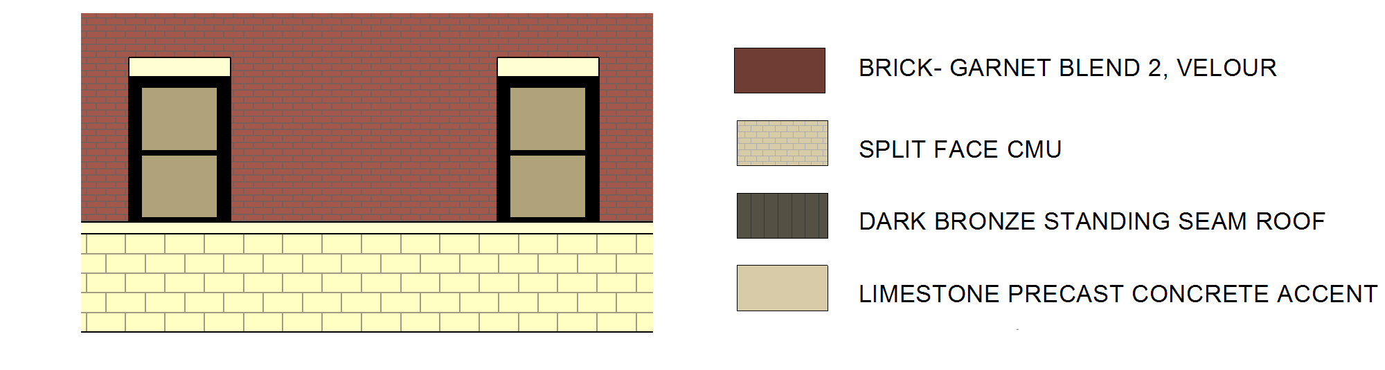

I have created a colored elevation where the RGB settings for my CMU and limestone are set to 215-203-168. I have created a legend with filled regions for the colors with the same RGB settings. However, they do not match each other. Any ideas on how to fix this?

Try using the actuall walls in your legend.

Thanks for the tip! I didn't know you could do that. I need to have an elevation though.
Also, the legend colors are correct and the elevation colors are wrong. I can't seem to adjust the elevation colors to be correct. They are always too yellow or just white.

I found the problem. The elevations were set with the sun from the top right at 80 and "use sun position for shaded diplay" was turned off.  When I turn on "Use sun position for shaded display" and set it to 50, the colors mathched. Thanks for the help!
