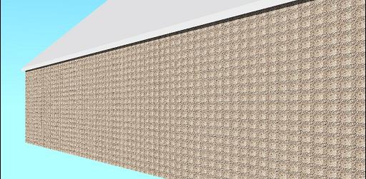

Will9000
Joined: Fri, Jan 28, 2005
117 Posts
4 Stars: 5 Votes
all my jpegs that i attach to the render scene have a tiled affect and not a true surface see attached jpeg, any suggestions as to how to do this Thanks
Tue, Sep 6, 2005 at 3:57:38 PM | RE: modelling interior nightclub
Xane
Joined: Tue, Feb 15, 2005
90 Posts
That tile is to small so is not possible to recognize material. First make tile bigger. Edit material, go on map tab, select image and then edit. Now input new size, and depends of your material if it is rough stone set bump to + or -. Go back to main page and set 'reflective finish' and may be highlight if your material is polish granit, try some values. First of all you must have good tile map or your wall will look on 'carpet', try to find real tile map not use ordinary map for tile.
