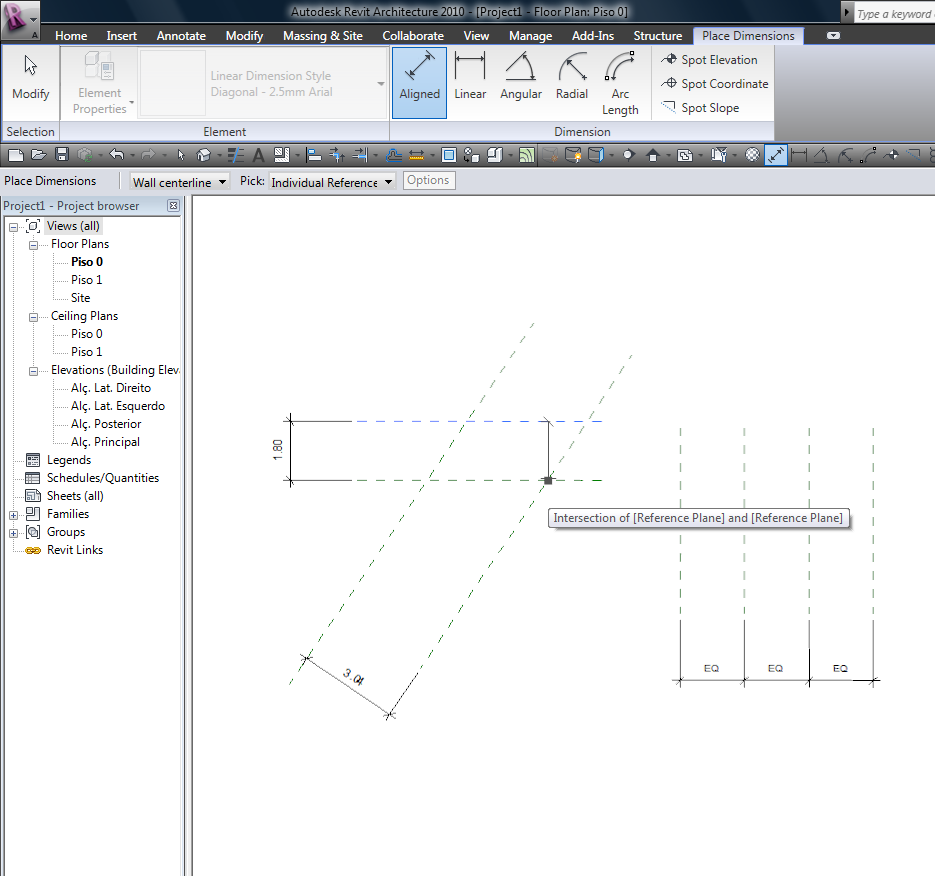

Hi all,
Seems like tagging dimensions over reference planes is nomore available in 2010. or am i wrong?
Don't really have much time to explore 2010 ribbon interface but it definitely slow down my speed, guess have to look into shortcut keys as I reckon that is a good way to change my work of working revit in the future rather than icon based.
A good tip will be much appreciated...thanks in advance
Life is never easy but nor it should be complex. Just stay simple Smile

Ale02, what do you mean with "tagging dimensions over reference planes" ???

What I really mean is putting dimension over reference planes and use them as construction lines or something
Used to do that mainly to equal divisions so I can copy things such as windows/ stiffeners equally to distance or between columns.
Seems like that does not work in 2010

Ale02, i really don't see any problem with dimension in ref. planes in 2010, it's the same in 2009....

guys...thanks for the tips...
managed to solve the issues as I was clicking linear insteads of aligned dimensions..
I am pretty much of an acad user and think as an acad user too...
btw, what the different between aligned dimension with linear dimension..seems like linear dimension cannot impose on reference plane...
