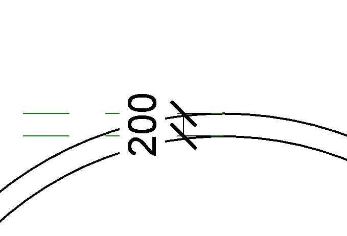

83 Posts
 Thanks to both for replying.
>as the dimensioning in revit is fairly intelligent overall,
The one bit of dimensioning that still seems to be missing is for curved wall widths (thickness).
 At the moment I'm having to add temp reference plans (see attached). Iis there abetter way?
 Cheers
Dave F.
