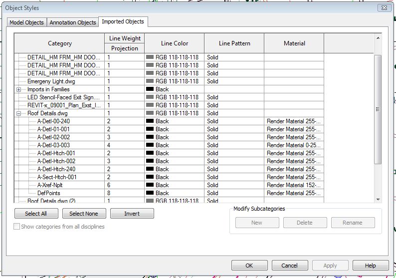

Over the last year, I've been adding to our companies Revit template and everything came along really well, but I did notice that some CAD files I had once linked in have left behind some DNA. Looking at Object Styles > Imported Objects, I noticed files I've long removed from my template file. How can I completely remove these?
I am able to remove the individual layers, but not the file name (see attached image).

I couldn't find any hidden CAD files. I checked 'Manage Links' and none are there, but still those Imported Object Styles remain.

Actually no, these are/were files I used and removed; I am the only person working on this template file. I had already checked for hidden files, and even removed all views, sheets etc etc to see what's left over. the files listed as shown in the image were left unchanged.

Looking at the names, these files were all imported/linked into the main file, and not in families. I'm clueless. Also nothing in View Templates.
I tried out both importing and linking a CAD file with a few layers, checked the object styles (they showed up), removed the file and checked the object styles again (they were gone again). I don't understand why those others would still remain when I'm doing the exact same thing here.

You obviously opened all views ... did a reveal hidden elements... turned on everything and all imports....
Here is a suggestion.  Start purging everything in your file from the browser including elements in use.  Do it a cluster at a time.  Start with model then detail families.  When it finally drops, you will have it isolated.
You can then open a new copy and remove only the problem.

Actually, that's something I had done a long time ago, yet I always assumed it would be part of a view or something alike, so I never went to Purge the remaining partin of the template.
It doesn't really make sense, but I found it as a Family with one of the CAD names, which then contained every other CAD file that was also listed there.
Whatever it was, I'm glad it's gone!! Thanks WWHub!!
