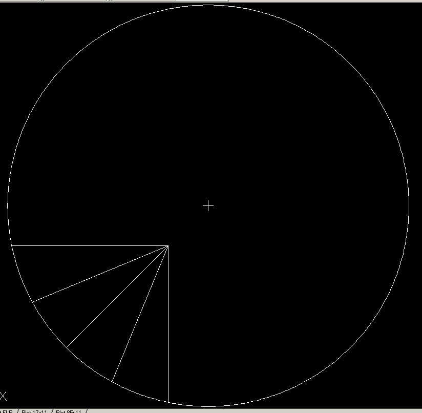

I need a Geometry 101 lesson.  I am trying to determine the lengths of three lines within a circle.  I have all the information regarding the radius, the endpoing locations within the circle, and the angles of each line.
What I don't have is a formula that links this information together and provides me with a line length.  Can anyone help me with this?
How can I find this length?  See attached image.
Thank you in advance!

Your image doesn't highlight what information you know and what you want to find out...??

Yes, I understand it doesn't match verbatim.  I should clarify.
Three of the five lines are unique.  Two of them are at 90°, two of them are at 22.5°, and one of them is at 45°.  Therefore, I have three unique line lengths I am looking for.
What I know.
The five lines are not radiating from the center of the circle.  They are radiating from a point 45° from the center of the circle.  Let us assume it is 4'-0" in each direction.
The radius is 20'-0"
The angles are as mentioned above.  But, to be technical, they are located at 0°, 22.5°, 45°, 67.5°, and 90°.
That is what I know.
What I don't know, and what I want to find is:  The length of each line (really, I only need to calculate the length of each unique line, thus 3) from the point they radiate to the point at which they terminate (at the 2-'-0" radius).

By the way.  I am trying to build a complex nested family which I hope will be fully parametric.  These line lengths are the missing link.

You've probably already seen this, but it may help.
http://mathforum.org/dr.math/faq/formulas/faq.circle.html
And this which is more in line with what you are trying to achieve:  http://www.gamedev.net/community/forums/topic.asp?topic_id=554266
And this one... Which does something very similar but more complex...
http://www.physicsforums.com/showthread.php?t=185755&page=2

The second link looks most helpful.  Thank you very much sir.
