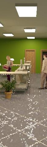

Hi!
I have problem with rendering in Revit Architecture 2010. I used predefined "medium" settings but this came out:
White dots from light. How can I fix this?
thx for help

Reduce the reflectivity and tone down the bump mapping.  They also will resolve themselves if you render at higher quality settings...

This material has only brightness (i didnt found reflectivity on this one)
Where can i edit bump mapping in materials?
Can it be problem that the image is not good pixel quality?
thx for help

Try a region render at high or best quality first to see if it fixes the issue.  Its generally to do with the number of bounces for reflectivity in your render settings.  If the surface is bumpy it can take extra effort...

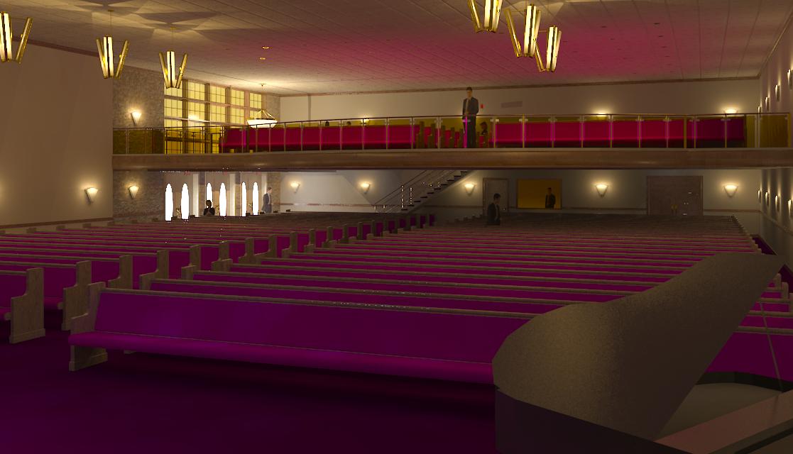

Spot, I have reduce the reflectivity in this scene, and the pew material color still reflect to the ceiling.

I'm rendering at High at 600 DPI in office ower night so will se the result tomorrow ...

The result looks good at High, but it rendered whole night.
