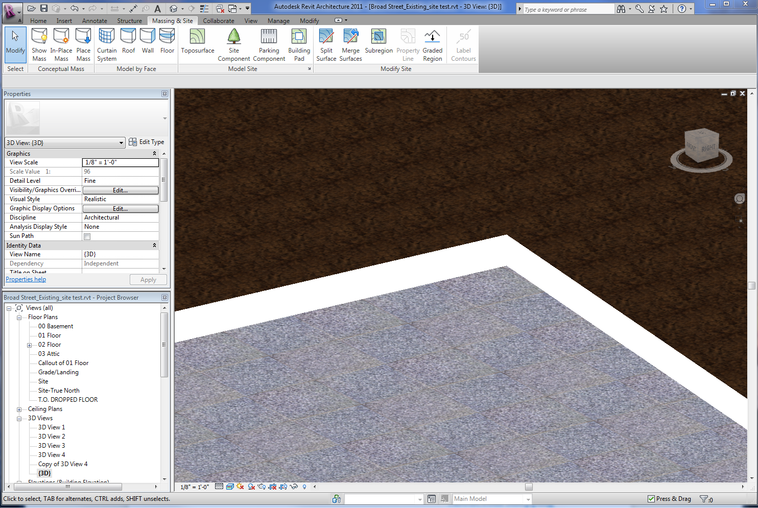

Mr. Spot,
I've taken your advice and set out to create my roads and sidewalks using the split surface command and then dropping the split surface to a lower lever.  However, upon dropping the split portion, I am able to see a gap between the original toposurface and the newly split & dropped surface (see image).  Is there a way to fill in that gap so it doesn't look like the split surface is floating below the original toposurface?
Thanks!
Thu, Feb 2, 2012 at 4:11:01 PM | Building Pad Errors
Mr Spots advice was for PADS where you would never see this gap.....You have found out why you should not do this for roads and walks...
On flat sites you can do this for parking areas if you add a curb.  Obviously sidewals should be higher - not lower and on flat sites, we use slabs for walks.
For sloping lots.... you have a lot more work if you really want to model this grade change rather than just changing the surface material.  You can do it by editing your topo before spliiting and adding apprpriate elevations at the split line.

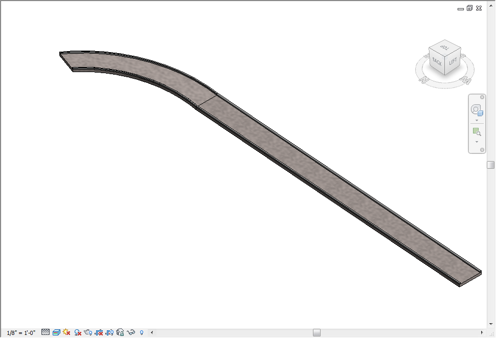

This is a useful way to build a nice road. It is a little time consuming but you can see the results.
The first is using ramp the curbs are railings.

Fri, Feb 3, 2012 at 4:46:24 PM | Building Pad Errors
#10
berginarchitect
berginarchitect Avatar
Joined: Thu, Feb 24, 2011
29 Posts
4 Stars: 1 Votes
mbsteve,
Thank you for your suggestion.  I actually came across another post of yours where you suggested this method, but quite frankly, it made my head spin.  It's probably not as difficult as I'm making it out to be but with my limited experience, it's a little more than I want to tackle right now.
Thank you though, I appreciate your help.
