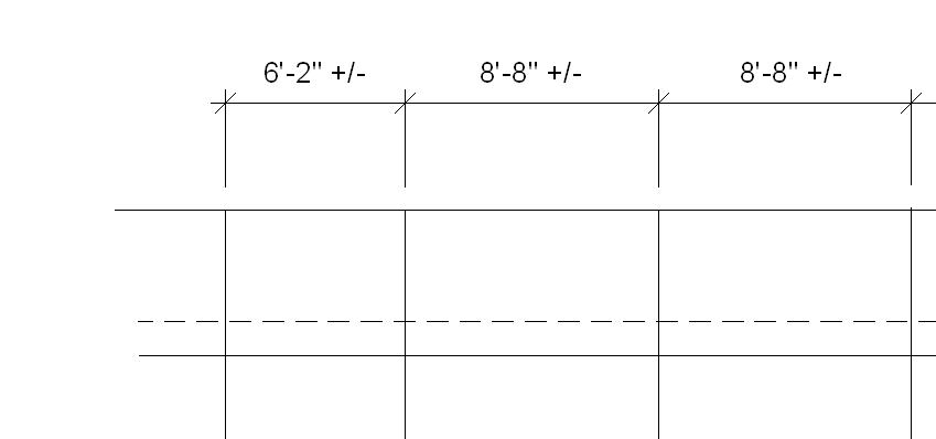

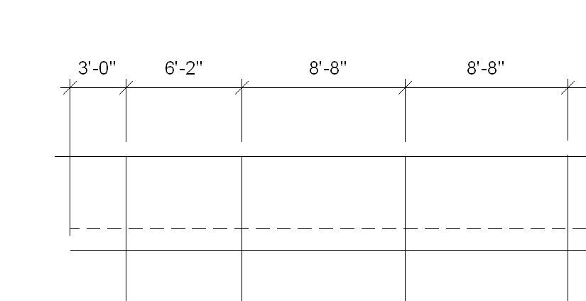

Am I doing somrthing wrong or what? I try to dimension plans and that is already hard enough for it to pick all the right points that you want. But when you have a string of dims and you need to add more to it anything that you have done to the origional string of dimensions is now reset back to default. I'm constantly adding text to dimensions and it never stays when I have to add more to the witness line later. It seems like the best thing to do is to wait till the very end of a project before you dimension anything but that doesn't fly with the boss/architect/owner to see no dimensions. Anybody have any easy tips on how to dimension things without this problem happening???

Hard to pick the right thing?  Tab key; you should be hitting that sucker in your sleep!
But that's probably beside the point (and no I'm not badgering you).  I would just dimension items individually.  One dimensions string per element dimensioned.  Yeah, it's not an ideal solution, but it keeps your text in-tact.  And I agree- it is very annoying.
