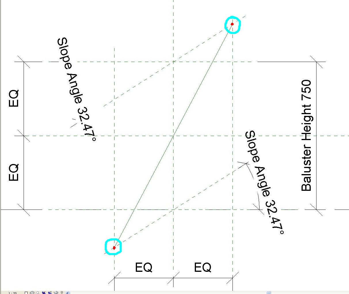

hello i wanted to know how can i lock lines end points (red dots) to crossections of reference lines (cayan circle), so that when i change slope angle my line points stay locked to those crossections points....i hope that made any sence
i've been siting all day with pencil and peace of paper trieng to calculate the formula to lock angles to that slope angle but  with no succes....si i think i have to lock those points ....bu i cant find a way to do that....pls help

Download this, it will help you understand this process: http://revit.downloads.autodesk.com/download/RAC2009/Families_Guide/ENU/Family_Guide/PDF/ArchitectureFamiliesImpENU.pdf
