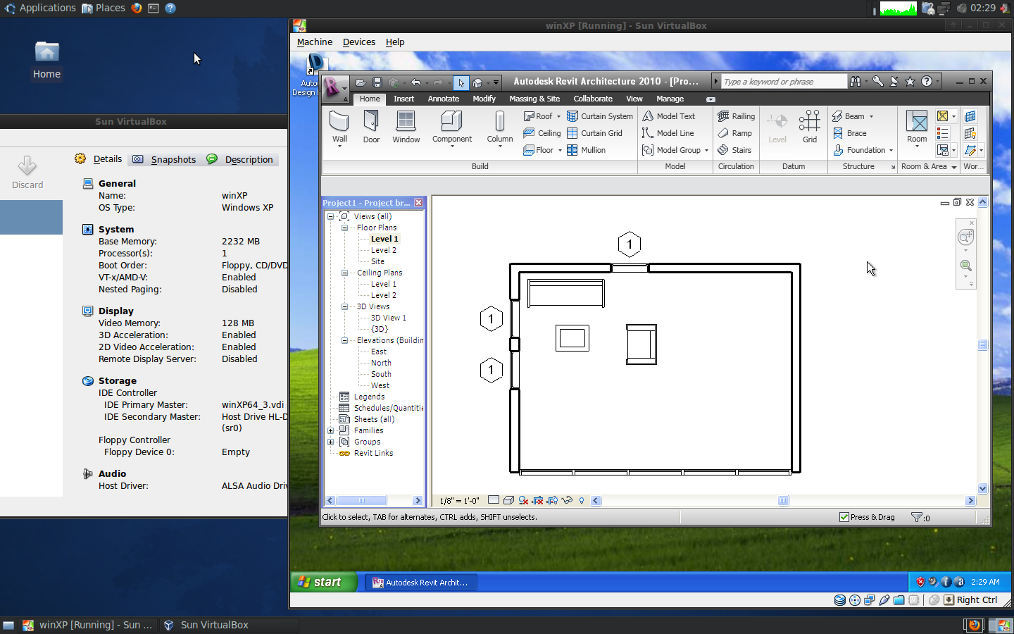

Okay boys and girls... I finally used Revit within a virtual machine within LINUX!!!
(Before you ask "WHY LINUX???" please realize that question could be an ENTIRELY different thread.)
I've been waiting a while to do this, and after Autodesk offered support on Macs via Bootcamp, I decided it was time to give it a go in the Linux world. I must also admit I was inspired by one of the RevitCity guru's (rkitect) and his build, which is a MacbookPro that runs Windows XP via Parallels and Revit.
Here are my test parameters:
  • Xubuntu 9.10 64bit for the Host OS
    • NO DUAL BOOT
  • abandoned Dell Vostro 1700 laptop
    • this machine is close to the specs of a similar Vista machine I frequently use for Revit remotely from the office.
  • stock processor (1.8Ghz Intel Core 2 Duo E8000?)
    • I'm unsure of the EXACT processor product code, but I do not think this chip fully supports hardware virtualization (VT-X) which means that I am POSSIBLY not using the processor to its fullest potential with both cores.
  • 3Gb Kingston ram
    • This upgrade was done as a quick fix before the original user was given a newer replacement system.
  • Windows XP Pro 32bit
    • It was my first choice to run 64bit, but I believe a lack of hardware virtualization was failing me (FOR THIS PARTICULAR PROCESSOR CHIP.)
  • Revit Architecture 2010
  • VirtualBox
    • This is my virtualization software to create the virtual Windows XP enviroment.
The goal of this experiment was to simply install and run Revit 2010 in a virtualized guest OS within a Linux/Unix based host with open source virtualization software. The end result would help prepare myself for eventually bringing this open source solution to a production system at our office.
The setup preformed AMAZINGLY well. The biggest issues were related to Dell hardware and the Revit DVD having conflicts with Linux and the processor for this particular machine. I believe the processor failure really short-changed my experiment and nerfed my performance.
Using Revit was a breeze. Since the Guest OS had only the responsibility to run Autodesk software, I did not have to bog it down with other tasks that seem to clutter my desktop. It also booted very quickly. Rendering time was rather poor. I still have a lot of bugs to work out with the hardware virtualization with the processor which I think will greatly improve this. Most all other functions behaved as expected on this system.
I plan to proceed with implementing this solution to a production system. The anticipated gains are based on my other duties, such as server administration. Linux will afford me the greater security that I cannot get out from using Windows and also will keep me in the Linux environment. The anticipated cons are based on the overall interoperability of the open source software. Other solutions may need to be created as the project continues.

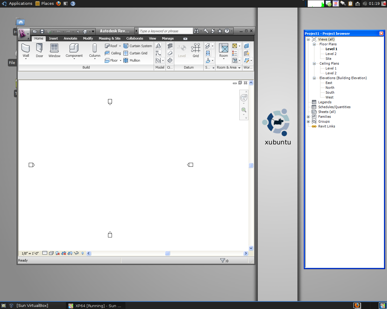

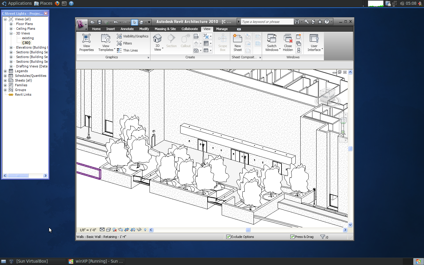

UPDATE:
I tested a larger file in 3D and it worked about as well as could be expected on a very low end setup (refer to first post in this thread for details.) This means there was expected choppiness, but it did not appear that I was going to crash the setup just because I wanted to move the 3D view around or so awful I would not proceed to a better graphics setup. An odd glitch I noticed was the difficulty to pull the project browser from the Revit window. I was not very concerned because the right method to performing the action with success was quickly learned, and the project browser has always appeared to me to be a bit hesitant to leave the comforts of home. Puh
I have also installed a package for VirtualBox called “Additions” which allowed me to go into a “seamless” mode. The seamless is rather simpler than it appears which makes it fairly buggy. The intent is to bring your Microsoft application windows out from the virtual machine and onto the desktop of the host machine (Linux in my case). This gives the appearance that you are running Revit in Linux. The simplicity of it is that the behavior is the virtual machine has gone to a full screen mode but the Microsoft desktop and the clutter that is on it has vanished leaving you with a visible host machine desktop and the Microsoft task bar and any open application window. The bugs that pop up seem that they would be inherent due to this behavior I described. The results are that the Microsoft windows are always on top, and drag and drop of the host desktop does not function. The good news is I can either enter the shortcut to leave seamless mode or, since I am using Linux, I can just switch to another workspace.
I still intend on bringing this setup to a production machine soon. With the holidays coming up, this should fit nicely with my waining schedule! At any rate, my concerns for the future are the overall performance of the graphics card through the virtualization software, particularly DirectX.
The crashes that I have had have been in been adjustments with the virtual machine. For example, the installation of Additions hurt my virtual machine until it restarted. Now all appears to be in order. I have also abandoned the setup for long periods of time with the virtual machine running. There have been no glitches or noticeable affects of deterioration from extended uptime.

UPDATE:
Revit is now installed in a virtualized, guest installation of Windows XP Professional 64bit on a production machine with Xubuntu as the host operating system.
During the next three days before the holidays, standard operations will take place on this machine to see how it compares to its previous setup of Revit installed on a standalone, single OS installation of Vista Ultimate 64bit.
The improvements already seen are in the basic operations of the virtualized guest OS. XP (as expected) performs much more quickly and handles Revit graphics more smoothly (i.e. panning and zooming in 3D).
Vista was also tested in a virtualized environment set to the same parameters as XP, but the resources were much more compromised in Vista, specifically the graphics.
Currently, the biggest downgrade is the expected drop in performance due to sharing resources amongst two OS's, but XP has the lowest footprint in the resource pool as compared to Vista.
At the moment, I do not see any reason to switch back. As stated before, I have reasons to work within a Linux environment so the sacrifices are negligible. I am considering doing a write up on the setup, if anyone has desire to research it and create their own virtualization setup to utilize a specific OS.
